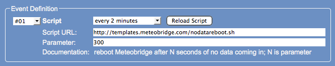

Your call might look like this:
Screen Shot 2015-01-14 at 23.07.46.png (24.01 KiB) Viewed 4702 times

So I just need to host nodatareboot.sh on my webserver and then call the script with the MeteoBridge ?
Re: Auto reboot, potential feature?? **solved**
Clément wrote:Thanks a lot !
NO, You could but you should not do that. Do not host a copy of the script on your webserver. The script is for common use. So if there are additional features they will be implemented in that script. You only have to push the "Reload template" to use the latest version, and you will allways use the latest version after a restart.
You customize the script to your liking with your "no good data time" as parameter (300 seconds in the example) and the frequency of checking (2 minutes in the example).
