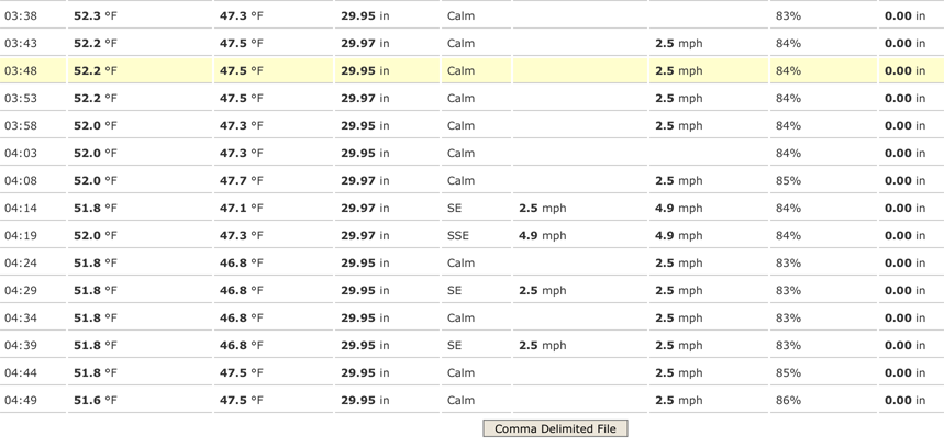

Hooked up MeteoBridge to my ObserverIP (hooked up as part of Ambient WS-1400-IP). Noticed in WUnderground tables that all wind speeds, regular, and gusts alike are (close to) multiples of 2.5 mph.

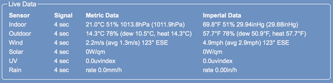

I investigated using the Live Data page on the ObserverIP and noticed that wind gusts are always coming from the ObserverIP as these same numbers, but wind is reported with all kinds of values with one decimal. I also sniffed network traffic and was able to observe the MeteoBridge calling on the livedata.htm web page of the ObserverIP to get its values. I know that it parses this data correctly, because comparing the same values with the live data page from the MB software shows the same values as obtained from the ObserverIP.
I do note, however, that what MB reports as wind speed (the first number), is actually the number reported by ObserverIP as the gust speed and what MB reports as the average speed (between parentheses) is what the ObserverIP sends as "wind speed".

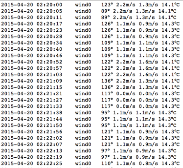

Looking at values received by meteoplug.com I see values such as 1.1 m/s which corresponds directly with the 2.5 mph measurement for the first value (assumed to be gusts) and 2.2 (the multiple) and values like (for example) 0.1, 0.2, 0.5 and 0.6 m/s for the second value. These correspond to 0.224 = 0.2 mph, 0.447 = 0.4 mph, 0.536 = 1.5 mph and 0.626 = 1.4 mph. These values are values the ObserverIP is capable of producing for the wind (not gust) speed.
So, I it seems that MB internally has the correct values (I am using Meteobridge 2.5 (Apr 14 2015, build 6256), FW 1.4 on a TP-LINK TL-MR3020) but is not sending the correct value(s) to WU.

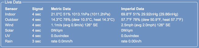

Attached are some screen shots from my Live Data page for reference and one from meteoplug wind values.

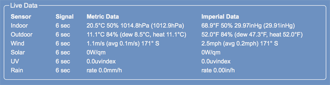

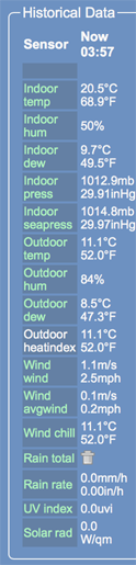

If you look at the attached screenshot from MB live data page, you will see reported that the reported "Wind avgwind" is 0.2mph and "Wind wind" is 2.5 mph. This may be coincidence, but the screenshot taken from the ObserverIP at the exact same time show "Wind Speed 0.2", "Wind Gust 2.5" (everything set to mph).
I am assuming (perhaps incorrectly so) that when MB reads the page from ObserverIP (that is how it gets the data, is it not?) and scrapes it, it finds these same two values. The value the ObserverIP reports as "Wind Speed" is averaged from its sensor over its reporting interval (about 8-14 seconds, not sure exactly).

Also, at this time the record uploaded to meteoplug was:
2015-04-24 03:57:41    wind0   171° 1.1m/s 0.1m/s 11.1°C
These values correspond to 2.5mph, respectively 0.2mph.
From this I conclude that MB decides that the value it sends as "windspeed" is not taken from the field that the ObserverIP calls "Wind Speed" and that comes from the "wind0" sensor. This would seem to be, however, the logical choice and that is what I am asking to be changed. It would seem reasonable that WUnderground receives the same value for what is the same logical variable as does, for example, MeteoHub.
As is, data on, for example, meteohub simply does not correspond to what one would think is the same data on WUnderground (or inside MB). It has a weird side effect in that if one looks at the wind speed/gust graph on WUnderground, one can see that wind speeds are quantized to the aforementioned multiples (I cannot attach this as a fourth attachment so I will attached it in the following post). If one has the ObserverIP upload instead, this is not the case an we see all kinds of in-between values like 0.2, 3.6, etc. This (using ObserverIP instead of MB) is obviously not the solution I am looking for, given that I have invested in MB hardware and a software license for it.
So hopefully, you understand better what I mean now.

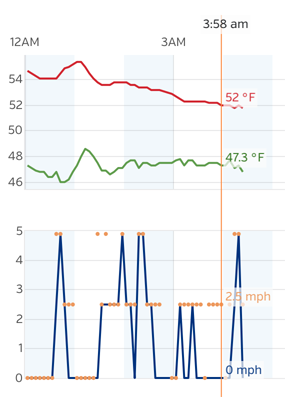

Here is the screenshot of the quantized WU wind data from the same period. I have highlighted (vertical line) the specific timeslot in question. Blue is what WU received as "windspeed" and orange is "windgust".
On the line we see a case where the uploaded gust was 2.5, but the uploaded speed was 0. There is, unfortunately not an exact capture of that dataset show in the previous post, but I have looked at many intercepted posts to Underground and windspeed is always one of the multiple values. See this table attached as well (the columns are: temp, deep, pressure, wind, wind speed, wind gust, humidity, rainfall hourly).
