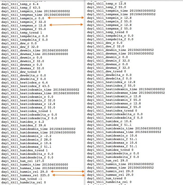

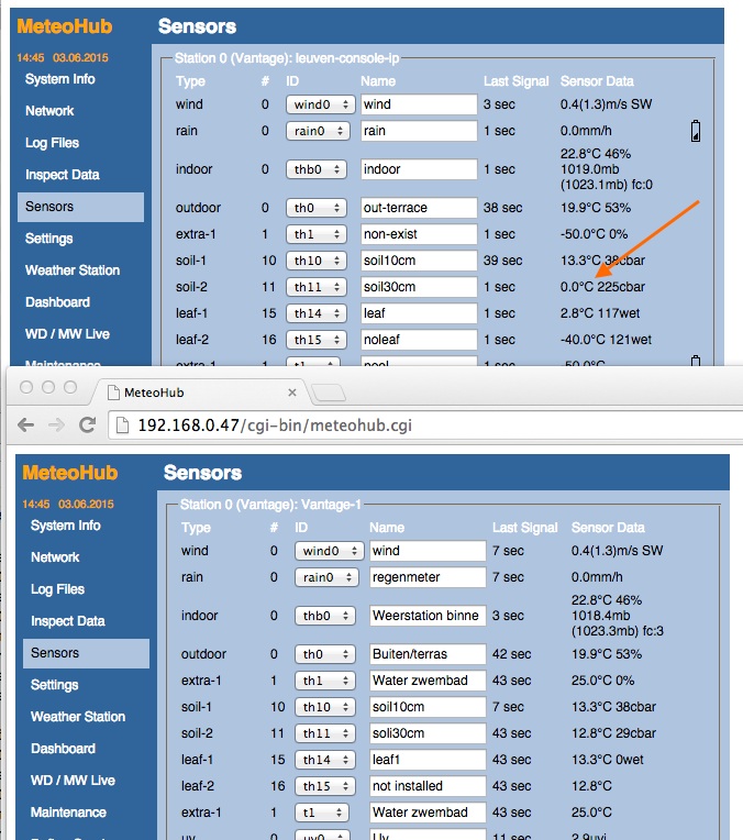

All day Meteohub-1 receives normal sensors info, sometimes Meteohub-2 sensors page shows out-of-range values which make nonsense of the min-max values.
Image top part is second Metehub, bottom part first Meteohub (click on the image to enlarge)
soil sensors2.jpg (181.96 KiB) Viewed 1941 times
Left is second meteohub which used the out of range values to mess up moisture and temp min/max values.
soil sensors1.jpg (238.82 KiB) Viewed 1941 times
These error values occur during Meteohub to Meteohub communication using an IP network.
So how are these errors introduced?
If the first Meteohub accepted the values, they should arrive un-modified at the next Meteohub.
If the first one rejects the values, it should not sent those values on port 5550.
