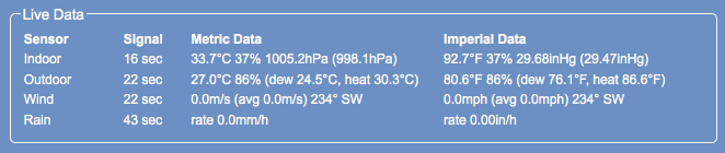

a) I use a TP-LINK TL-MR3020 + Davis WeatherLink® for APRS (#6540) but not see the "Live Data" .
I use one serial to USB direct on the TL-MR3020 but and via usb-hub and set the baud rate of Vantage to 19200 but has no effect .
Now I have a connection to a WeatherLinkIP™ for Vantage Stations and works correctly.
b) I also had the same problem with viewtopic.php?f=56&t=10461 and I have hassle very much.
I'm afraid to change something in Setup In order not to hardship again .
Any idea ???
George .

Re: TP-LINK TL-MR3020 + WeatherLink® for APRS (#6540)
Can login and see live data on "live data" tab.
As you are not using the mandatory USB hub, USB
connection will drop here and there and will cause
the problem of no data showing up. Please use a
USB hub!
I didn't realize this. WLIP is also fine, so no need to switch to a USB data logger or a USB hub.
Anyway, data is coming in on "live data" tab. Therefore, I don't see a problem.
Is just your APRS upload not working? Or what is wrong?

Hi again ...
The WLIP is temporary the is normally a Weatherlink For APRS .
Now have put a USB hub and USB to Serial .
Please a look the TP-Link with the information who thy have sent ...
George.
