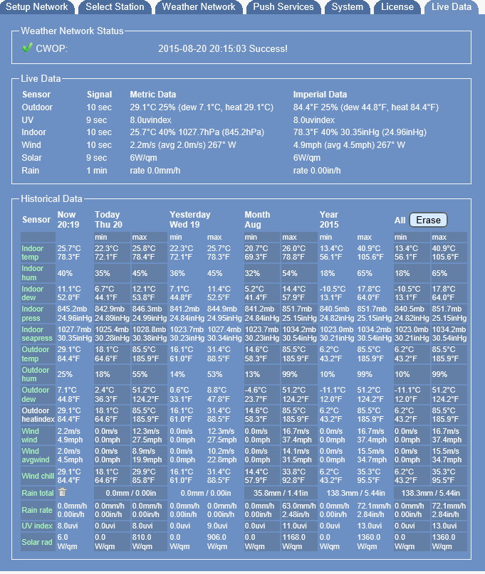

During the last three days, my Solar Data is doing some jumping around between the ObserverIP and MB. I send data to WU direct from the ObserverIP and there are no data anomalies. MB reads data from the ObserverIP and sends it to CWOP, where I noticed the anomalies. The data is such that one out of 10 or so 5 minute samples (MB) is correct and the other points are single digits values. http://www.findu.com/cgi-bin/rawwx.cgi?call=EW7016
The data on the ObserverIP has two decimals and its Firmware version has not changed within this period. I have rebooted both devices with no change. I am at a loss as to what could be happening.

As I don't have an observerIP with solar data sensor, I would be happy to remotely login to your Meteobridge to solve the issue.
Can you please give me remote access as explained here: viewtopic.php?f=57&t=9885

Thanks but the issue went away as mysteriously as it came. A month ago it was the rain data that jumped all over the place and resolved itself also. Multiple reboots seem to do the trick.
