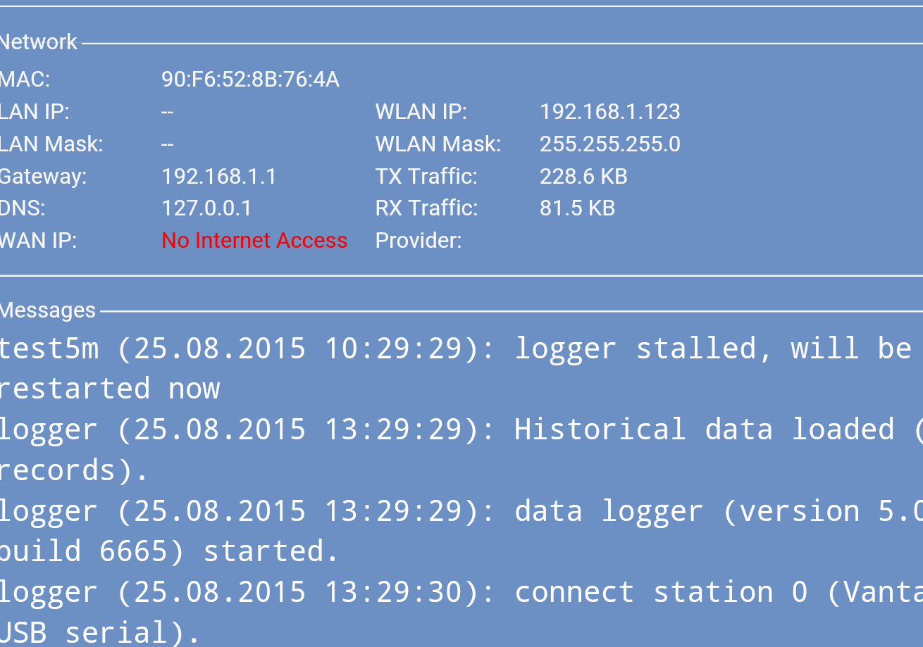

Meteobridge on 3020 stopped uploading today. Under system tab "Wan ip : No internet access " appears. But I can remotely connect meteobridge interface so device is connected to Internet. Also I have updated values under Live data tab. What can be the solution for this ?

When pulling this page, Meteobridge tries to connect to the outside to
find out its WAN IP. In order not to block the page, this times out after a
couple of seconds. Anyway, this is a symptom of a weak/slow Internet
connection.
