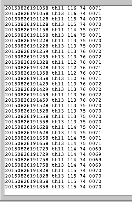

But raw data shows also identical data:
pic2
pic2
Where is the difference?
P.S Data enters via Plugin,does this matter? If i go back some days before, i always had 10th's humidity. And it displayed ok...?

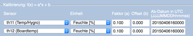

Nevermind... found it !
I set calibration value for this sensor... and forgot it.
