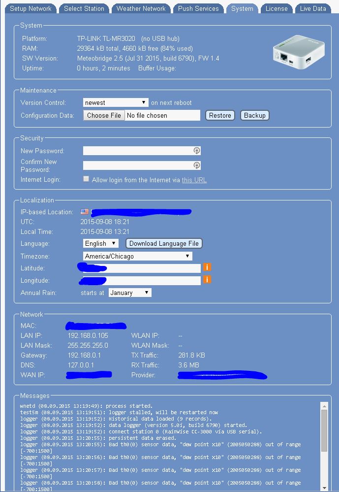

System messages are as follows:
wnetd (08.09.2015 13:19:49): process started.
test5m (08.09.2015 13:19:51): logger stalled, will be restarted now
logger (08.09.2015 13:19:52): Historical data loaded (9 records).
logger (08.09.2015 13:19:52): data logger (version 5.0i, build 6790) started.
logger (08.09.2015 13:19:52): connect station 0 (RainWise CC-3000 via USB serial).
logger (08.09.2015 13:20:55): persistent data erased.
logger (08.09.2015 13:20:55): Bad th0(0) sensor data, "dew point x10" (2005050288) out of range [-700:1500]
logger (08.09.2015 13:20:56): Bad th0(0) sensor data, "dew point x10" (2005050288) out of range [-700:1500]
logger (08.09.2015 13:20:57): Bad th0(0) sensor data, "dew point x10" (2005050288) out of range [-700:1500]
Bad th0(0) sensor data out of range

Re: Bad th0(0) sensor data out of range
I should add that the Weather Oracle display shows all of the information correctly, and I switched receiver boxes between the cc-3000 and display (no change).

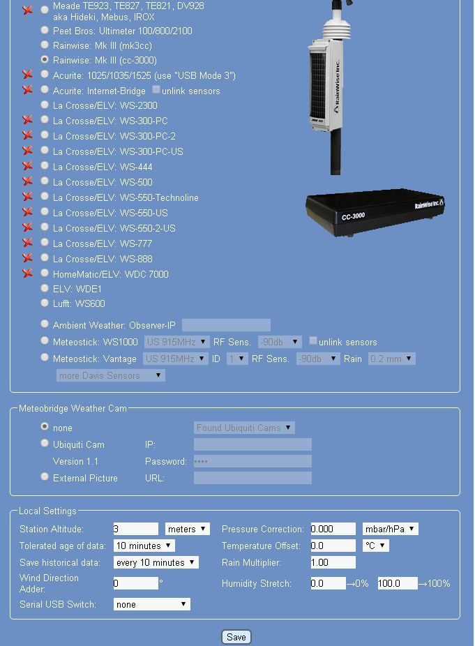

Meteobridge reads with 115200 baud from CC3000. May be your CC3000 is configured to another baud rate?

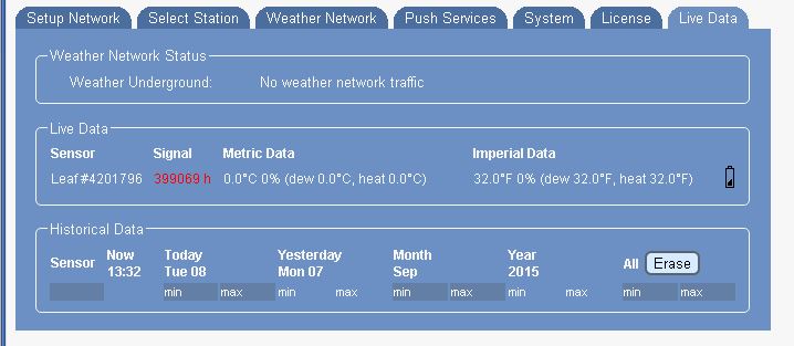

I didn't change any settings on the cc-3000. Every once in awhile it gets good data, but not consistently.
Configured and password sent. Thanks for the help!
It had a blip of good data at 4:26 PM...
2:04 PM -- °F -- °F -- % -- -- mph -- mph -- in -- in -- in
2:15 PM -- °F -- °F -- % -- -- mph -- mph -- in -- in -- in
2:53 PM -- °F -- °F -- % -- -- mph -- mph -- in -- in -- in
4:26 PM 86 °F 75 °F 70 % South 13.9 mph 13.9 mph 29.87 in 0 in 0 in
4:59 PM -- °F -- °F -- % -- -- mph -- mph 29.86 in 0 in 0 in
5:49 PM -- °F -- °F -- % -- -- mph -- mph -- in -- in -- in
