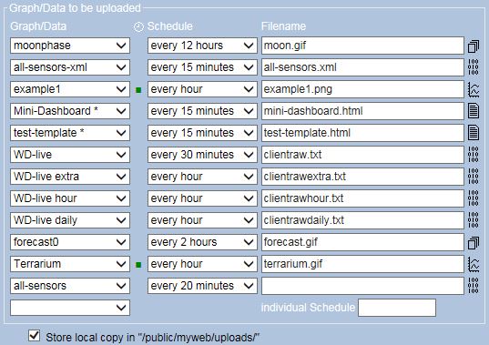

I have cleanup the data for every each month from 2009 till 2015 and still it freezes.
Also there is no much uploads defined in my opinion, see screenshot.
About the cpu load after the Weather Data Recomputation is done:
System Load: 0.03, 0.02, 0.03
Meteohub FTP Uploads.JPG (66.55 KiB) Viewed 23666 times
Regards / Grüß,
Geert - ON1DQD
