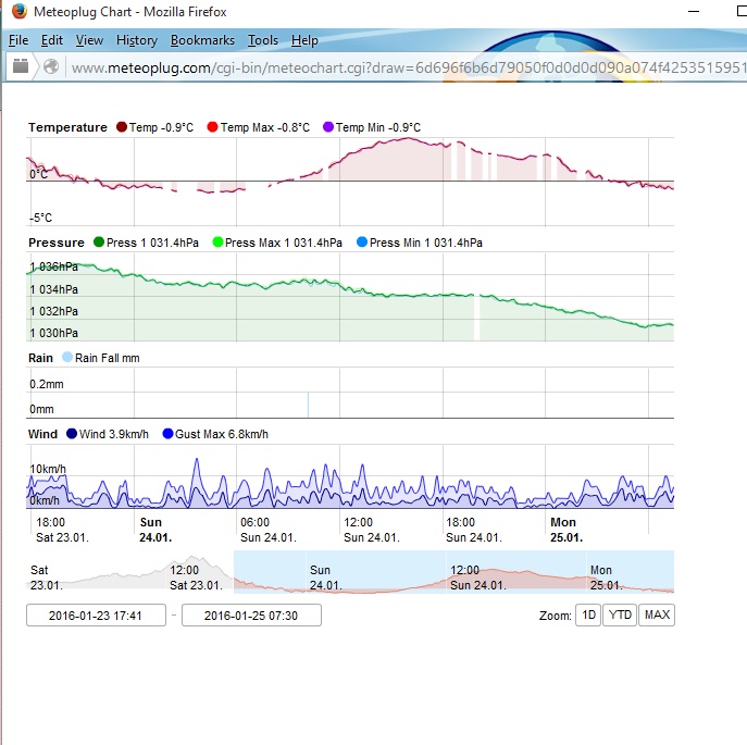

Hello all
I'm new to meteohub and have the problem that temperature und humidity graphs (and only those!) often are showing gaps in the signal transmission, cf screenshot.
I do not see this problems on the console, and I changed the place of the MeteoStick xesveral times without improvement.
Do you need more indications to help me?
thanks in advance
Martin
PS: The gap in pressure graph is due to a change of place of the MeteoStick
thanks in advance
Martin

Re: Version 2.6 intermittent loss of signal
Hi all,
I also have the same gap problem (as user iatros above) with the temperature and humidity graphs on Meteoplug. The gaps appeared when I started using a Meteostick attached to my Meteobridge (before that, the Meteobridge was configured to read the data directly from the WeatherLink IP module over the network).
I have recently upgraded to a Meteobridge PRO (red), and I get the same gaps when using the built-in RF receiver.
I am not sure, but this may be a reception issue with the th0() sensor (which reports the outdoor temperature and humidity), because there are, indeed, missing th0() values when I inspect the data on Meteoplug.
Chrys
Chrys
Update: After updating to the latest version of the system software, the gap issue has been fully resolved. I have been using the latest version for the past 48 hours, and there are no gaps in either the temperature, or the humidity, on Meteoplug.
Thanks for resolving this issue.
