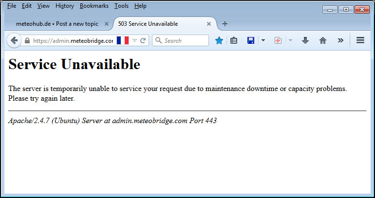

Is the Meteobridge remote access server down? I have been unable to remotely access my meteobridge server for the past several hours. It's always worked in the past but I'm getting the "Service Unavailable" error message below
- Meteobridge_Remote_Access_Issue_11082015.jpg (81.47 KiB) Viewed 9986 times

Problem you encounter is not that some centralized infrastructure is down, but that the remote tunnel your Meteobridge did try to setup is not working for some reason. As this depends on many factors, I can hardly isolate why it is not working in a current situation. As it works in many situations I decide to have it implemented. Please remember that none of the other weather products out there is even capable of doing something close to that. I will try to improve this over time, but this is really difficult.
When you need bullet proof remote access, please do it the way you do it with all your other equipment in your LAN. Simply tell your router to forward a certain external port to port 80 of the Meteobridge in your LAN and if you are on dynamic WAN IP your router needs also to setup a dynamic DNS access with one of the the free DYNDNS services out there. Nothing special on Meteobridge here.

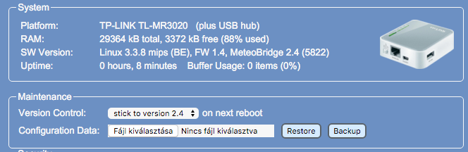

when i try to oldest versions, the 2.4 (5822) is works !!!
Admin please check whats the problem with new versions!
- Képernyőfotó 2015-11-11 - 7.45.55.png (61.03 KiB) Viewed 9856 times
