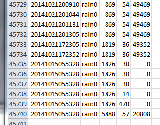

hmm. when importing and sorting the file from 10-2014 in excel, i do get some high values as shown in the attachment.
if only i knew how to map these values onto the values of the bold line below :?

20141001000000 0.5 0.0 588.8 4976.40 7 is referring to the entire month.
Keep in mind that the file rain0-month1 will just contain a single line for each and every month. So this is your statiscal information that has bene collected for that month.
Most likely are the 0 values and 20808 values confusing the aggregate functionality. It appears to me that those entries are not correct and should be removed from the raw file.

YJB wrote:Most likely are the 0 values and 20808 values confusing the aggregate functionality. It appears to me that those entries are not correct and should be removed from the raw file.
I analysed all raw files in excel and removed all the lines containing ridiculous values. Have to wait a few days for the results though :| (the system is running on a NSLU2 with weather data from 2008 up until now. recomputation takes around 5 days :P)
