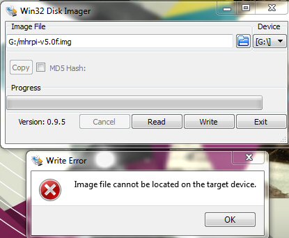

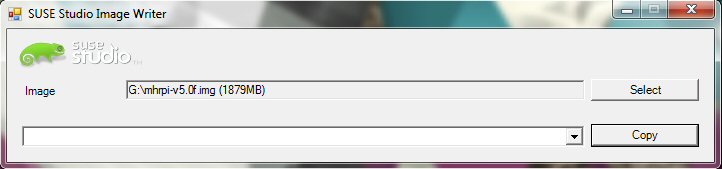

I try to install meteohub on my microSDHC card, Verbatim 32GB.
I try with imagewriter and win32DiskImager, but no success.
What can be wrong?

Hopefully you've figured this out, but the error message says it all. You can't take an image file that exists on a card, and write the resulting image onto the same card, because it overwrites the entire device. Copy the image file to your local HD first.
