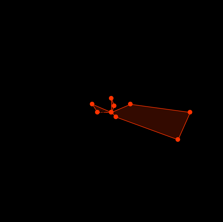

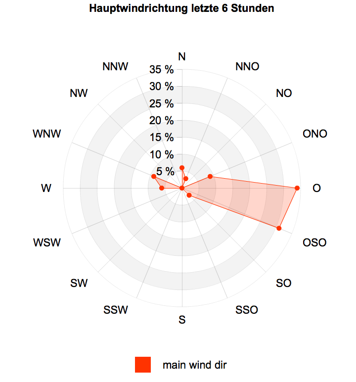

Unfortunately "Radar" does not work well as js
#engine=js
timeframe=6h              # set total time frame to previous month
dirlist=N,NNO,NO,ONO,O,OSO,SO,SSO,S,SSW,SW,WSW,W,WNW,NW,NNW
gtitle=Hauptwindrichtung_letzte_6_Stunden  # name of graph
gheight=400                 # height in pixels of graph
gwidth=400                  # width in pixels of graph
glunit=_%                   # show percent as unit on axis and balloons
gtype=radar%                # radar graph shows directional distribution in percent
res=minute15
sid0=wind4 sfill0=20 sname0=main_wind_dir ssel0=maindir sprec0=0
Flash is perfect, but wanted js has black background only while the Data is visible:
Flash
Flash
Bildschirmfoto 2015-12-24 um 00.46.05.png (102.27 KiB) Viewed 3690 times
JS
JS
Bildschirmfoto 2015-12-24 um 00.46.27.png (25.73 KiB) Viewed 3690 times
