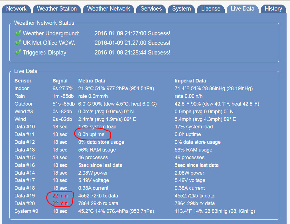

MB Pro running SW 2.6
A minor issue but on the Live Data tab, uptime remains at zero and the bandwidth use figures only change once when the logger starts or is restarted and then do not change again. Attached image shows issue - system uptime is just over 10 hours (from system tab) and logger was restarted by changing station setup temporarily to trigger logger restart.

Uptime bug is confirmed. It is just in the live data display. Historical data and data store have correct uptime data. Will be fixed with next update.
Unfortunately, I cannot reproduce your traffic volume issue on my MB PRO. Would you mind to give me access to your MB PRO, so that I can checkout what is behind this? I would need the URL and the password (instructions: viewtopic.php?f=57&t=9885). Please send to "info(at)meteobridge.com".

I have sent the url and password to info(at)meteo...
Re: MB Pro - minor issue with Live Data
I found the bug. Will be fixed with next update.
