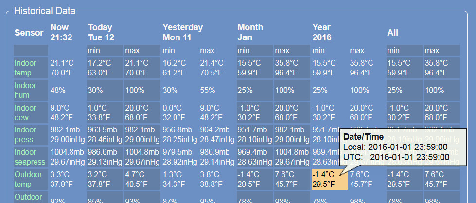

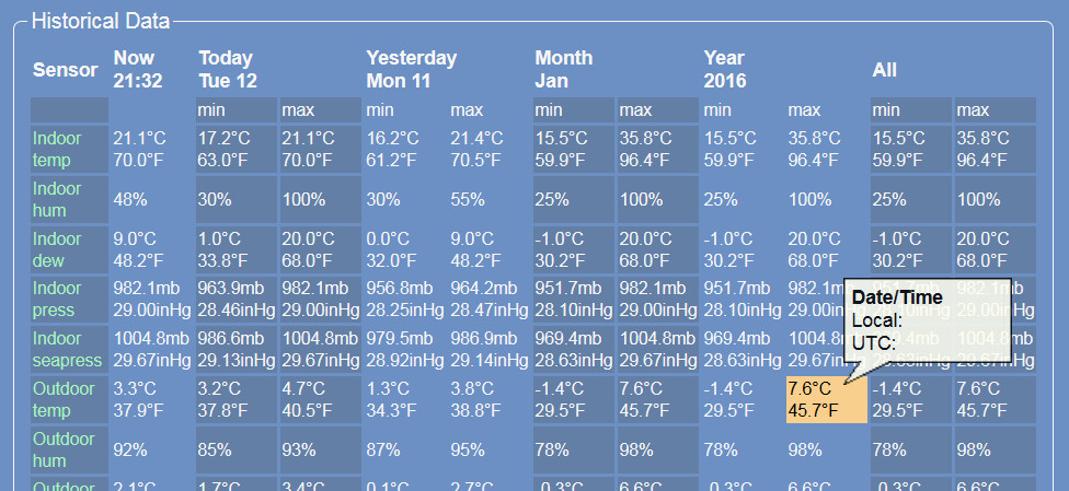

I got my MP Pro on Jan 7th and decided to enter the min, mean and max temperatures for the missing days in January so I would have a complete month. For each day I entered the min, mean and max temperatures at 23:59 against th0temp.
One of the low values entered was the lowest of the month/year so far and reports correctly with timestamp when called in a template and when mouse is hovered over value in Live Data. Another of the values was the highest of the month/year - this reports the temperature correctly against [th0temp-mmax] and [th0temp-ymax] but [th0temp-mmaxtime] and [th0temp-ymaxtime] do not report any value and show blank when mouse is hovered over the data in Live Data. Images below show low reporting a timestamp but high not reporting a timestamp.
MB Pro Manual Min Temp.jpg (171.92 KiB) Viewed 2117 times
MB Pro Manual Max Temp.jpg (178.21 KiB) Viewed 2117 times
Re: MB Pro - Manual entry of high temp doesn't get timestamp
I can confirm the bug. This just happens, when data is entered manually.
fixed with current release.
