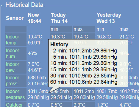

The details about delta selectors on the template wiki suggest that a positive number shows that the value being reported has increased.
I am using the following variable in a template :
[thb0seapress-delta1h=.2:--]
And it currently returns the value -0.70
The problem I have is that the pressure is rising and I was expecting a positive value - am I misunderstanding something or is trend giving the opposite of what was intended?
The current rising pressure trend can be seen in the image below :
MB Pro Trend.jpg (86.53 KiB) Viewed 2370 times

That seems to be the same problem as I have written about 20 hours ago. It looks as though positive and pegative Delta values reversed.
viewtopic.php?f=56&t=10667
Re: MB Pro - Delta selector reporting wrong sign
There is something not completely right. Will be fixed with next update.
