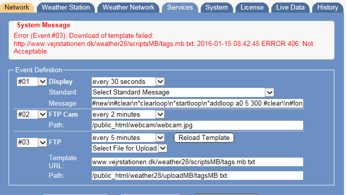

I have two different problems handling templates with ftp.
1)
MBP refuses to download this template:
http://www.vejrstationen.dk/weather28/s ... ags.mb.txt
The strange thing is, that it works if I grab the file, from another user of Leuven template.
Could it be ISP related, or why do I get this error?

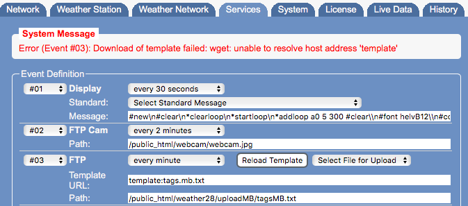

2)
Tried to store the file locally in folder templates, and gives me another error.
Any help would be appreciated :)

Re: MB Pro - Storing tempates locally
ad 1) wget, which is used by Meteobridge to read the data is blocked by your hoster of the web pages.
When I add "-U meteobridge" - which means I hide that wget is being used - download goes fine, but that
could have effects on other web sides. I will give it a try with the next update and we'll see if that opens
another can of worms.
ad2) It is just an error message that does not reflect that pressing the download button for a locally stored file is not making sense. So this is just cosmetics. A more useful message will be part of the next update.

Post by plex »
admin wrote:ad 1) wget, which is used by Meteobridge to read the data is blocked by your hoster of the web pages.
Hello
I've managed to solve it, however I don't know if it's the right thing to do?
Added this to .htaccess
<IfModule mod_security.c>
SecFilterScanPOST Off
SecFilterInheritance Off
</IfModule>

Post by plex »
admin wrote:ad2) It is just an error message that does not reflect that pressing the download button for a locally stored file is not making sense. So this is just cosmetics. A more useful message will be part of the next update.
File doesn't get processed here
Sorry, I am not that deep into web server configuration. By adding "-U meteobridge" to my wget calls does work around blocking of wget requests from the web server.
