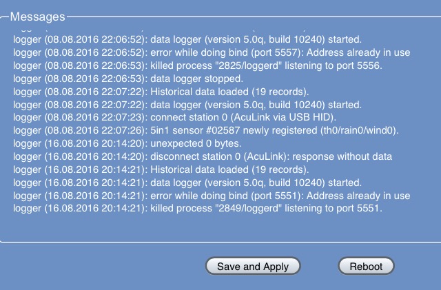

Still having this issue with no resolution.
Every time it starts to rain, Meteobridge stops collecting data from the outdoor sensor.
However, as you will see in the attachments, the sensors are fully functional and report perfectly fine through AcuLink Backyard Weather.
Is this something within the software, a reset that needs to initiate?
Please help me out. I'm here to answer any questions the admins have.

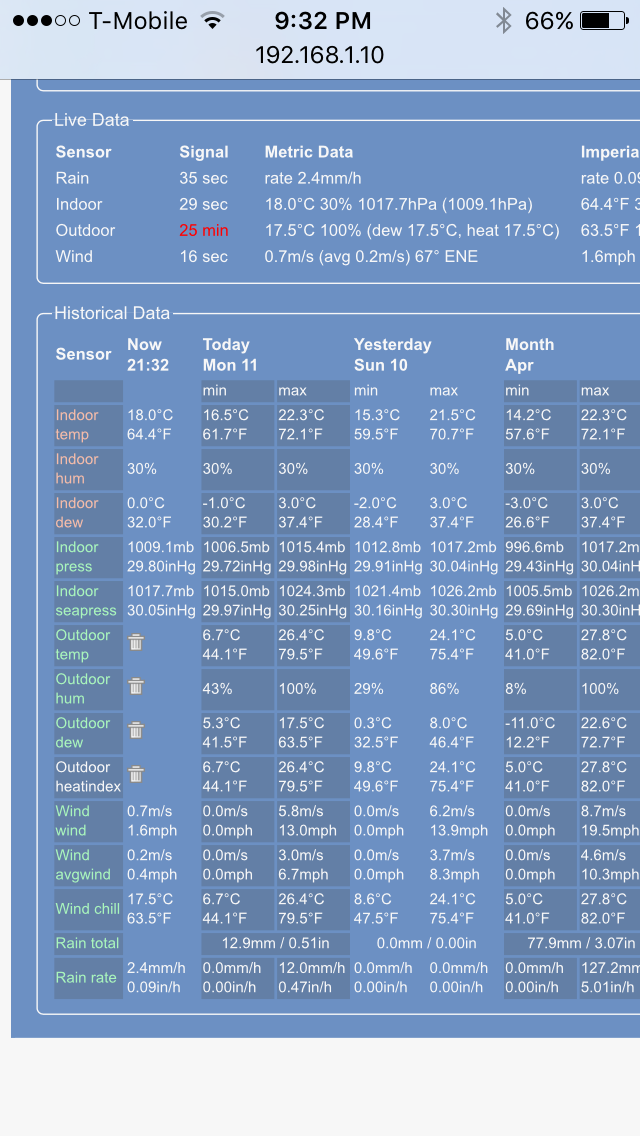

Re: Aculink Bridge Disconnect Issue
And aculink showing full sensors and reporting correctly to WU.
Here is the screenshot

The fix only worked for a short time. It continues to stop logging as soon as it rains or humidity hits 99%+. No ideas at this point.
Adding screenshot
