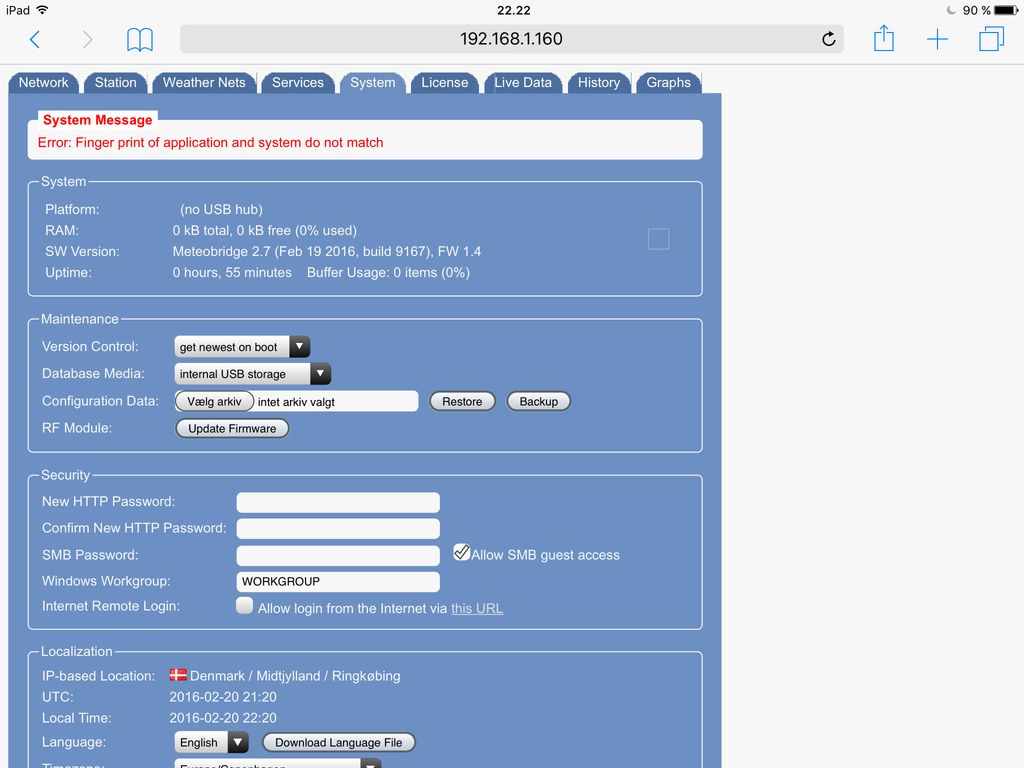

Today I rebooted my MBP red, to get the latest firmware.
A few hours later, I got mail from wunderground that my station stopped reporting. I tried to access the user interface, but got the message "Failed to fork child: Resource temporarily unavailable"
What does it mean?
It's running after a power cycle with a few errors - I don't know if it's something to worry about (database is locked).

After one hour it crashed again :(
I get the same error trying to access user interface, and ip-adress from lcd is gone. However it's still visible is my lan...
Also display is still showing new weather data, so it's not like completely crashed.
How can I revert?
I think my old version was dated 10th of feb.

Yet another 55 minutes and this happened :roll:
Posts: 8010
Re: Failed to fork child: Resource temporarily unavailable
Should be solved with latest update. Please reboot.

admin wrote:Should be solved with latest update. Please reboot.
Thanks :)
Still going strong after 2 hours, however I still see a few database errors.
logger (21.02.2016 08:25:15): DB cannot retrieve th0temp_min (20 tries, 5524ms): database is locked
logger (21.02.2016 08:25:38): DB cannot retrieve th0hum_min (20 tries, 5516ms): database is locked
