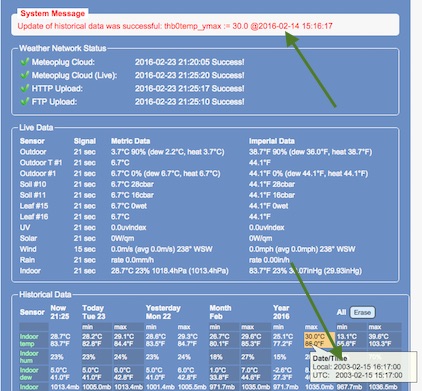

I am adapting the Template WiKi for my users on how to set historical values when moving to a MB and therefor I made some examples and screenshots.
But when I change a value the red line at the top displays correctly what i entered:
Update of historical data was successful: thb0temp_ymax := 30.0 @2016-02-14 15:16:17
The new value in the history is correct, but the date is wrong. It seems as if some fields ar moved 1 position to the left.
This is the result:Local: 2003-02-15 16:17:00
I tested a few times, rebooted to get the latest release and tested again.
Platform: ASUS WL-330N3G (no USB hub)
RAM: 29992 kB total, 4204 kB free (85% used)
SW Version: Meteobridge 2.7 (Feb 22 2016, build 3022), FW 1.0
Uptime: 0 hours, 17 minutes Buffer Usage: 0 items (0%)
I attach a screenshot,

Your time stamp is wrong, seconds are not allowed.
I will change code with next update to ignore seconds anyway...

admin wrote:Your time stamp is wrong, seconds are not allowed.
Thanks, it is described correctly in the WiKi but it was too late in the evening and I overlooked.
Just used the same time format as in the tooltip.
