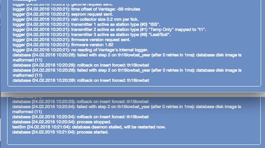

Message: disk image is malformed => no history displayed
The uploads halted and the only thing which was strange were these messages.
Reboot solved all, I thought. but in a few minutes:
logger (24.02.2016 10:23:00): no reading of Vantage's internal logger.
logger (24.02.2016 10:24:05): DB cannot retrieve wind7avgwind_day (20 tries, 5504ms): database is locked
logger (24.02.2016 10:24:24): DB cannot retrieve thb9seapress_year (20 tries, 5504ms): database is locked
logger (24.02.2016 10:24:42): DB cannot retrieve data12num_day (20 tries, 5504ms): database is locked
logger (24.02.2016 10:25:12): DB cannot retrieve data18num_month (20 tries, 5504ms): database is locked
logger (24.02.2016 10:25:31): DB cannot retrieve th0hum_min (20 tries, 5518ms): database is locked
logger (24.02.2016 10:25:36): DB cannot retrieve th0hum_day (20 tries, 5543ms): database is locked
database (24.02.2016 10:25:41): failed with step 2 on th16lowbat_year (after 0 retries in 1ms): database disk image is malformed (11)
database (24.02.2016 10:25:41): rollback on insert forced: th16lowbat
dozens of the same last messages then
database (24.02.2016 10:32:01): rollback on insert forced: th16lowbat
database (24.02.2016 10:32:01): failed with step 2 on th16lowbat_year (after 0 retries in 1ms): database disk image is malformed (11)
database (24.02.2016 10:32:02): process stopped.
Upload seems to work fine
Biggest Problem: Updating historical data is impossible as all fields on the History tab contain only --
Will reboot again and see if these messages return for the third time.
mb stalled.jpg (76.56 KiB) Viewed 3170 times

Re: Message: disk image is alformed => no history displayed
After rebooting same messages, last one "process stopped"
Upload OK: including min / max values today <=> alltime are OK, all tags contain values and datetime stamps are there also.
But the history tab does not allow updates:
Error: Update of historical data failed: th0hum-val@00:03 := 80%
Seems that the rising temp is not shown on the history tab either.
@boris system is open if you want to inspect
