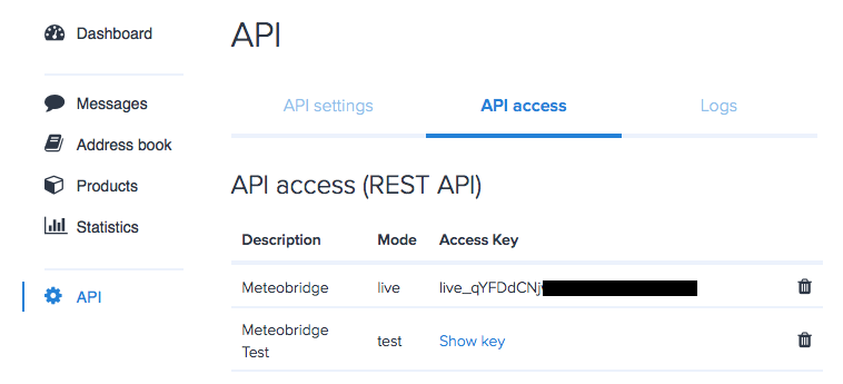

Actually, the "password" you are supposed to insert on Meteobridge is NOT the password of your MessageBird account. Once you are logged in on MessageBird, go to "API", then click on "API access (REST)" and then click on "Add access key". When asked, select the creation of a "live" key. Once the key is created, you should click on "Show key". This is the key that you should add to the Meteobridge SMS "Password" field. Once you hit "save", the red cross should change to a green tick.
The "Originator" can be anything (I think). It does NOT have to be your MessageBird username. It is the name that will show up as the sender of the SMS (when you receive the SMS).

Thanks, I still have to explain that in the wiki at the level of precision you just did. As you said, it is exactly working that way.

Are you using the API password which always begins with "live_"?
