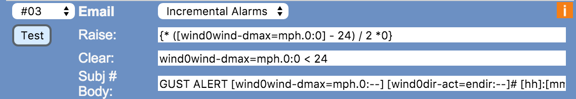

Please see attached screenshot to see if I perhaps missed something when entering your suggested syntax? Yesterday I had a peak gust of 33mph, and received alerts at 25, 30, 32 and 33mph. So obviously it's not firing alerts for even numbers or every 2 mph above 24mph.admin wrote:try
{* ([wind0wind-dmax=mph.0:0] - 24) / 2 *0}
Divides your integer result by two and makes an integer (zero decimals) of it.
Thank you.

Re: Incremental alarms syntax question
25 / 2 = 23
30 / 2 = 15
32 / 2 = 16
33 / 2 = 17
all as expected. "*0}" does rounding.
30 / 2 = 15
32 / 2 = 16
33 / 2 = 17
