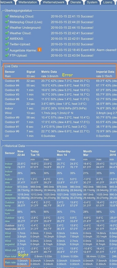

Good morning.
After setting the Rain Multiplier there is an error in the indication of Live Rain Rate. The current data is different from that indicated in the historical data section. The right data is the one indicated in the historical data section.
Station: Oregon Scientific WMR200.
See attached image.

Good finding. This has been overlooked. Will be solved with next update.
