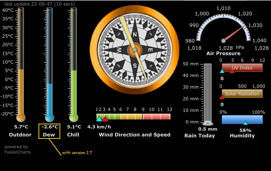

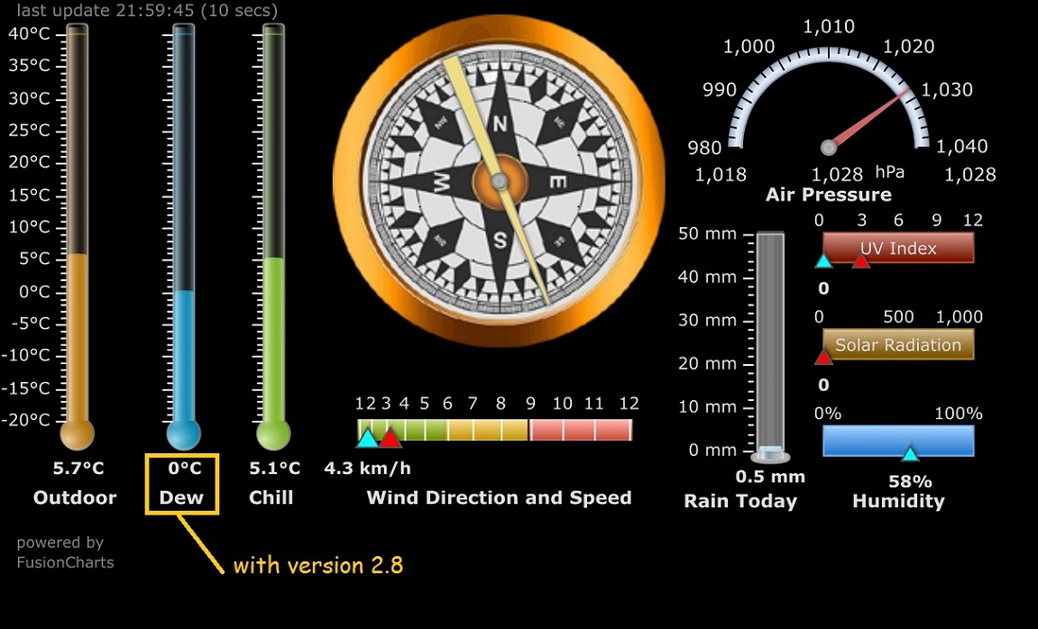

With the software version 2.8 in the live board the dew point is always at 0°C.
If the meteobridge is restarted with version 2.7 instead of the dew point is shown correctly.
(Station: Oregon Scientific WMR200)
See attached image.
With version 2.8
With version 2.8
With version 2.7
With version 2.7

Re: With version 2.8 - dew point in live board is always at
By changing handling of sending out leaf/soil sensor data the dew report for regular TH sensors has been broken.
This will be fixed by todays update.

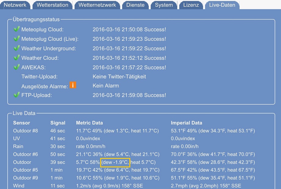

There is still a small problem. The data sent to live Meteoplug cloud service does not consider the humidity stretch and so it is a bit wrong. Thanks.
I have this problem yet. Is there a solution? Thanks!
Ich habe noch diesen Problem. Gibt es eine Lösung? Danke schön!
