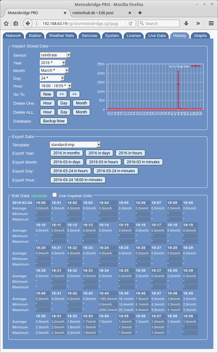

I have been having trouble with my Davis ISS not reporting as much rain as my graduated cylinder rain gauge. Some times the measurement is off by as much as 50%.
I created a test fixture that consists of a push button switch attached to a few inches of phone cable as a fake rain gauge.
Today, I hooked this up to the davis transmitter instead of the rain gauge, and pressed the button 20 times. This should have registered as 0.2" of rain, but zero rain was transmitted to Weather Underground.
I looked at the history page, and it shows a significant spike in rain rate. Attached is a screen shot. So the ISS is detecting the button presses, and transmitting them, but somehow the meteobridge pro is not recognizing them as measurable rain.
What is the ISS transmitting, and what is the software doing to the data that it is dropping rain?

Do I get you right that MB PRO just records the rain rate and does not increase total rain amount?

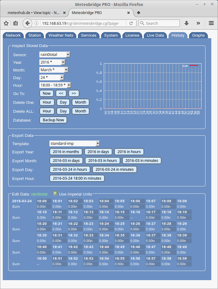

Can you please show same screen dump for "rain0total"?

Attached is the rain0total for the same time period.
What I fear is that the meteobridge pro is doing some filtering on the data, and that there is an incorrect assumption about the maximum rain rate and/or an error in their math.
