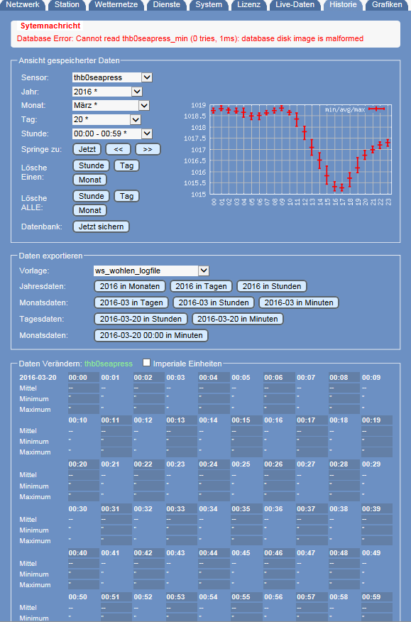

I have found today that in export log parameters completely missing (00:00 to 23:59). In the history I get the parameters thb0seapress at the chosen hour following error message "Sytemnachricht: Database Error: Can not read thb0seapress_min (0 tries, 1ms): database disk image is malformed". Other hours are available, even in the visible day graphics a value for the hour 0 is present. What happened here? More importantly, how can such be avoided?

- Database Error: Cannot read thb0seapress_min (0 tries, 1ms): database disk image is malformed
- mb_pro_database_disk_image_is_malformed.png (57.84 KiB) Viewed 3584 times
