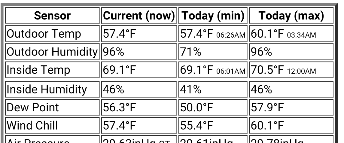

I have a timestamp on a few things, like the min/max temperature. It returns with the leading zero (see attached)
Sorry for the large size, I uploaded it from my phone.

You can select the to be skipped character and make use of an #if# #then# #else# #fi# clause to skip the leading char if it is a zero.
When you post one of your timestamp variable definitions, I can show as an example how to apply this.

I appreciate the help. Here is the code for the first line in the table image I posted earlier:
<tr><td>Outdoor Temp</td><td>[th0temp-act=F.1:--]°F</td><td>[th0temp-dmin=F.1:--]°F <font size='1'>[th0temp-dmintime=apm.ij:--]:[th0temp-dmintime.kl][th0temp-dmintime=apm.op]<font size='3'></td><td>[th0temp-dmax=F.1:--]°F <font size='1'>[th0temp-dmaxtime=apm.ij]:[th0temp-dmaxtime.kl][th0temp-dmaxtime=apm.op]<font size='3'></td></tr>
