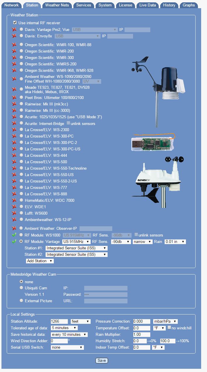

Ok, I have a Davis VP2+ and Meteobridge Pro
On the main station, I have the temp/humidity and rain sensor. Station #1
On another wireless transmitter, I have the wind, UV and solar sensors. Station #2 setup up via dip switches.
I set both up as ISS -- Was that correct?

Under Davis config the Wind can be a separate ISS but the UV & Solar is part of the main ISS which appears to be the same requirements for MB Pro

But I removed the solar sensors and placed them with the wind sensors...
Posts: 1492
Re: New Setup
The solar & UV sensors have to be connected to the ISS and there can only be 1 ISS (as such) configured. If you want to connect UV/Solar with the wind sensor then you would have to make the Anemometer transmitter the ISS and config your station #1 as a Temp/Humidity transmitter but then you have no rain (on station #1) unless of course you were to connect your rain collector to your station #2 (now being the main ISS)

Mb Pro -- I set up both as ISS
Re: New Setup
Screen dumps would really help. To me it is not clear what has been defined on "station" tab.
Screenshot 2016-04-04 crp.jpg (130.37 KiB) Viewed 4945 times
Screenshot
Re: New Setup
Settings look ok to me.
What data is shown on live data tab? Everything showing up there as expected?
