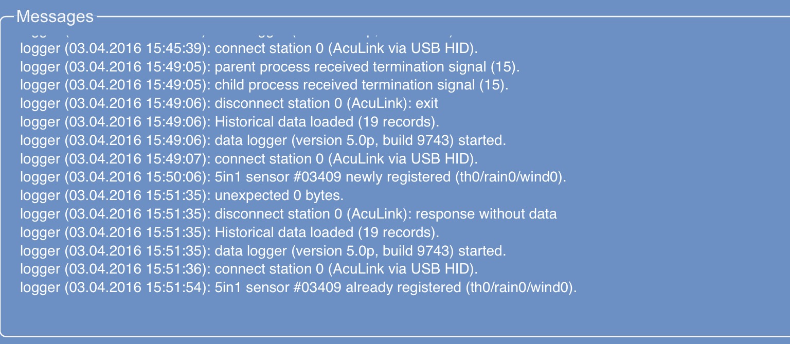

I have been having issues with my meteobridge and AcuRite internet bridge. Upon restart the log shows it started usb, not the bridge. If I unplug and use the register button on the AcuRite bridge, the meteobridge will eventually pick it up. I am using the TP-Link 3020 and it worked for a year up until approx 1 month ago.

I Confirm that I have the same setup as NT3401 and I have the same issue, every time that I have to restart Meteobridge it fail to communicate with the accurate bridge and after clicking save on the weatherstation page 4 to 5 time, it will eventually start logging and once started it will remain fonctionning until the next reboot, it been like this for at least 1 month and half
