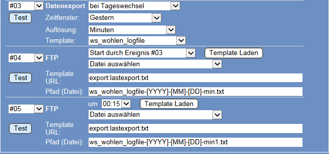

I have a question for FTP upload an export logfile. In WIKI I read about a fictitious "lastexport.txt" which is filled after each export with the file path. The last export file is not uploaded via FTP (FTP data is correct, test file is uploaded).
If I "#03" up out via test, the file in the directory "export" created correctly. I click then in "#04" or "#05" to test, no error is displayed, but also uploaded a file.
What am I doing wrong?
I want the last exported file with the original filename upload (currently "ws_wohlen_logfile-2016-04-10-min.txt"), I'm doing this?

I think it has something to do with the date stamps used in the filenames. I've tried that too, but it didn't seem to work. I hope that this feature will be added soon!

Similar on this one, also still working on getting this one to work.
