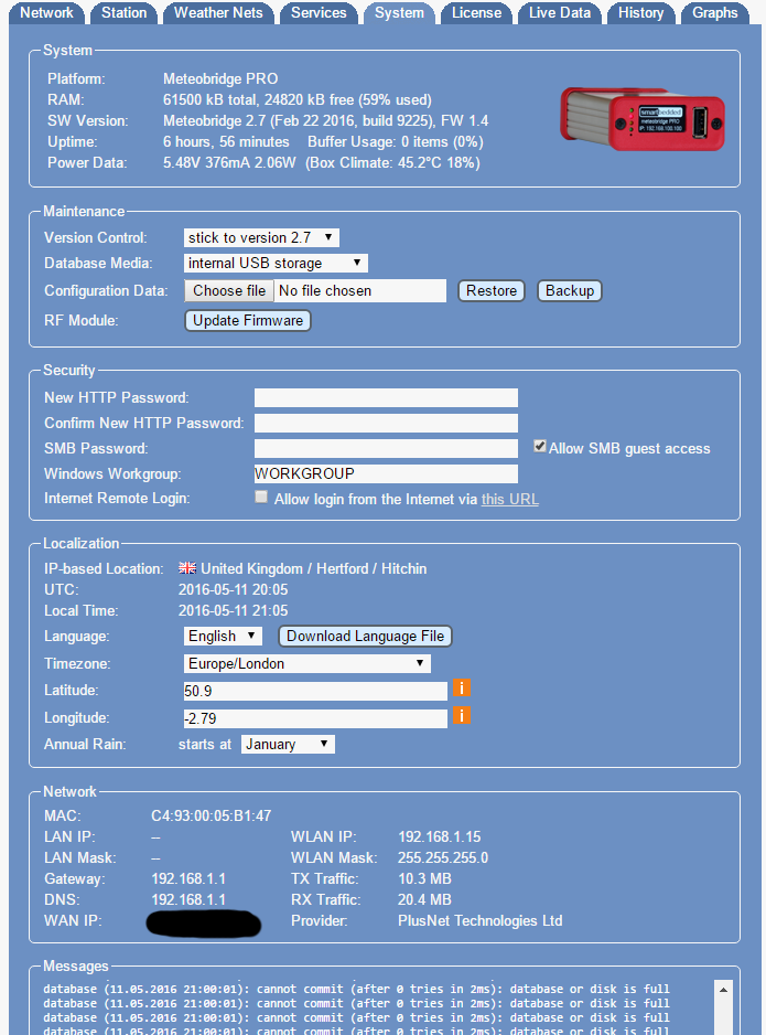

It happened again, this time using version 2.7 (which was previously stable. However it failed with a different error message
database (11.05.2016 20:47:06): cannot commit (after 0 tries in 2ms): database or disk is full
database (11.05.2016 20:47:58): cannot commit (after 0 tries in 2ms): database or disk is full
additionally the 'Status' page of the web interface was missing the 'Storage' statistics.
Is this pointing to a hardware problem?
Screenshot (46).png (124.19 KiB) Viewed 9264 times

logger (23.05.2016 14:46:59): DB cannot retrieve data14num_min (0 tries, 1ms): disk I/O error
logger (23.05.2016 14:46:59): DB cannot retrieve data16num_min (0 tries, 1ms): disk I/O error
logger (23.05.2016 14:47:00): DB cannot retrieve data17num_min (0 tries, 1ms): disk I/O error
logger (23.05.2016 14:47:00): DB cannot retrieve data18num_min (0 tries, 1ms): disk I/O error
logger (23.05.2016 14:47:00): DB cannot retrieve data18num_min (0 tries, 11ms): disk I/O error
logger (23.05.2016 14:47:01): unexpected 0 bytes.
logger (23.05.2016 14:47:01): station 0 (Meteostick Vantage), can't set attributes of device /dev/ttyMH to former values: Input/output error
logger (23.05.2016 14:47:01): disconnect station 0 (Meteostick Vantage): response without data
logger (23.05.2016 14:47:31): connect station 0 (Meteostick Vantage via USB serial).
logger (23.05.2016 14:47:33): transmitter 1 registered as ISS
logger (23.05.2016 14:50:57): parent process received termination signal (15).
logger (23.05.2016 14:50:57): child process received termination signal (15).
logger (23.05.2016 14:50:57): disconnect station 0 (Meteostick Vantage): exit
logger (23.05.2016 14:50:57): disconnect station 9 (System Data): exit
test5m (23.05.2016 14:50:58): USB storage remounted: /dev/sdb
database (23.05.2016 14:50:58): process started.
logger (23.05.2016 14:50:58): database connected.
logger (23.05.2016 14:50:58): Historical data loaded (0 records).
logger (23.05.2016 14:50:58): data logger (version 5.0p, build 9911) started.
logger (23.05.2016 14:50:59): station 0 (Meteostick Vantage), can't open device /dev/ttyMH: No such file or directory
logger (23.05.2016 14:50:59): connect station 9 (System Data via Plug-in).
logger (23.05.2016 14:51:29): station 0 (Meteostick Vantage), can't open device /dev/ttyMH: No such file or directory
logger (23.05.2016 14:51:59): station 0 (Meteostick Vantage), can't open device /dev/ttyMH: No such file or directory
logger (23.05.2016 14:52:29): station 0 (Meteostick Vantage), can't open device /dev/ttyMH: No such file or directory
logger (23.05.2016 14:52:59): station 0 (Meteostick Vantage), can't open device /dev/ttyMH: No such file or directory
logger (23.05.2016 14:53:29): station 0 (Meteostick Vantage), can't open device /dev/ttyMH: No such file or directory
logger (23.05.2016 14:53:59): station 0 (Meteostick Vantage), can't open device /dev/ttyMH: No such file or directory
logger (23.05.2016 14:54:29): station 0 (Meteostick Vantage), can't open device /dev/ttyMH: No such file or directory
logger (23.05.2016 14:54:59): station 0 (Meteostick Vantage), can't open device /dev/ttyMH: No such file or directory
logger (23.05.2016 14:55:29): station 0 (Meteostick Vantage), can't open device /dev/ttyMH: No such file or directory
logger (23.05.2016 14:55:59): station 0 (Meteostick Vantage), can't open device /dev/ttyMH: No such file or directory
logger (23.05.2016 14:56:29): station 0 (Meteostick Vantage), can't open device /dev/ttyMH: No such file or directory
logger (23.05.2016 14:56:59): station 0 (Meteostick Vantage), can't open device /dev/ttyMH: No such file or directory
logger (23.05.2016 14:57:29): station 0 (Meteostick Vantage), can't open device /dev/ttyMH: No such file or directory
logger (23.05.2016 14:57:59): station 0 (Meteostick Vantage), can't open device /dev/ttyMH: No such file or directory
logger (23.05.2016 14:58:29): station 0 (Meteostick Vantage), can't open device /dev/ttyMH: No such file or directory
logger (23.05.2016 14:58:59): station 0 (Meteostick Vantage), can't open device /dev/ttyMH: No such file or directory
logger (23.05.2016 14:59:29): station 0 (Meteostick Vantage), can't open device /dev/ttyMH: No such file or directory
logger (23.05.2016 14:59:59): station 0 (Meteostick Vantage), can't open device /dev/ttyMH: No such file or directory
logger (23.05.2016 15:00:29): station 0 (Meteostick Vantage), can't open device /dev/ttyMH: No such file or directory
logger (23.05.2016 15:00:59): station 0 (Meteostick Vantage), can't open device /dev/ttyMH: No such file or directory
logger (23.05.2016 15:01:29): station 0 (Meteostick Vantage), can't open device /dev/ttyMH: No such file or directory
logger (23.05.2016 15:01:59): station 0 (Meteostick Vantage), can't open device /dev/ttyMH: No such file or directory
logger (23.05.2016 15:02:29): station 0 (Meteostick Vantage), can't open device /dev/ttyMH: No such file or directory
logger (23.05.2016 15:02:59): station 0 (Meteostick Vantage), can't open device /dev/ttyMH: No such file or directory
logger (23.05.2016 15:03:29): station 0 (Meteostick Vantage), can't open device /dev/ttyMH: No such file or directory
logger (23.05.2016 15:03:59): station 0 (Meteostick Vantage), can't open device /dev/ttyMH: No such file or directory
logger (23.05.2016 15:04:29): station 0 (Meteostick Vantage), can't open device /dev/ttyMH: No such file or directory
logger (23.05.2016 15:04:59): station 0 (Meteostick Vantage), can't open device /dev/ttyMH: No such file or directory
logger (23.05.2016 15:05:29): station 0 (Meteostick Vantage), can't open device /dev/ttyMH: No such file or directory
logger (23.05.2016 15:05:59): station 0 (Meteostick Vantage), can't open device /dev/ttyMH: No such file or directory
logger (23.05.2016 15:06:29): station 0 (Meteostick Vantage), can't open device /dev/ttyMH: No such file or directory
logger (23.05.2016 15:06:59): station 0 (Meteostick Vantage), can't open device /dev/ttyMH: No such file or directory
The MBPro was essentially dead after the reboot, with no data stored in its internal database until I powered it off and on again.
Hope this helps narrow down the problem

It looks like a hardware failure, It died completely this evening and won't get past the 'landing page'.
Not very encouraging.
peterb
Posts: 26
Joined: Fri May 20, 2016 5:45 pm
Re: MB Pro suddenly stops uploading data
Post by peterb »
frogfoot wrote:It looks like a hardware failure, It died completely this evening and won't get past the 'landing page'.
The customer service is very good, this is what admin reported about mine: " ...... sorry to say, but the internal storage in your MB PRO has failed.
It will need a repair to replace the storage by a next gen module......" so I've sent it back to Germay postage paid today.
