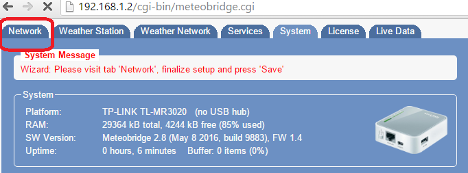

Every time I try to access the network configuration in the Network tab on my new TL-MR3020 it stops and reboots. All other tabs are ok.
Any suggestions on what the problem might be?

Success!
It started working after I replaced the USB power cable.
Problem solved.
Re: TL-MR3020 reboots when accessing Network tab
That is an interesting finding, but somehow logical as when accessing network tab
Meteobridge will start WLAN operation to find a list of available WiFI APs.
When power cable is faulty, this might "brown-out" the hardware.
