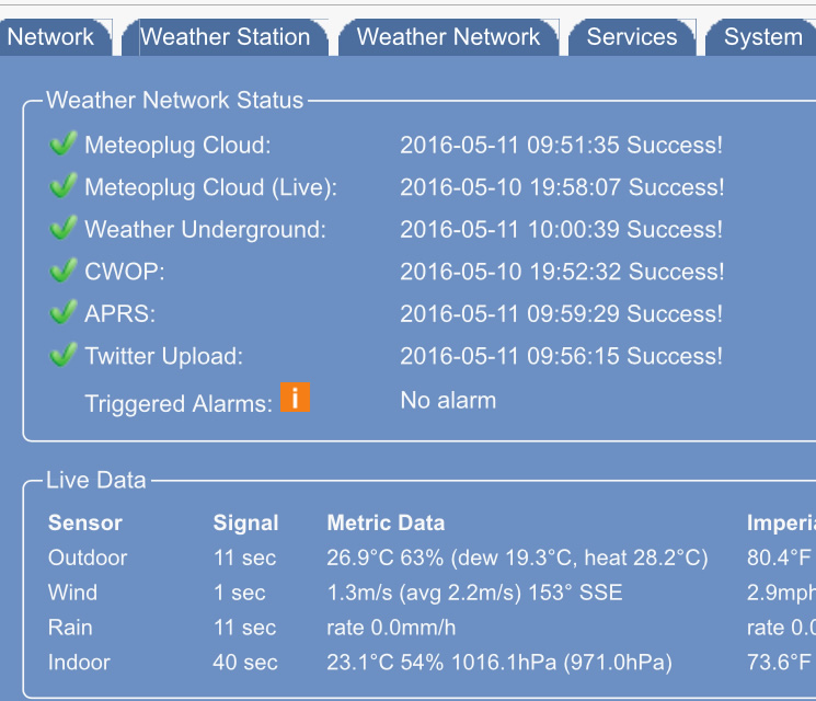

I'm getting some odd time stamps on various services. See attachment for a screenshot of how things are being posted erratically. My first thought was that the update I installed last night changed my local time, but I checked the time on my Meteobridge and it is set correctly. I've rebooted it, as well.
Plus, on Twitter feed (https://twitter.com/ElmSprings_WX), my posts are not only incorrect on their time stamp, they are not posting at a given interval (set to post every 5 minutes).
Anyone have thoughts on why it is behaving so erratically?

Update on this... without any intervention from me, all but CWOP updating has resolved itself back to correct timing. So, it seems to have mostly fixed itself (except for CWOP, which last posted yesterday).

WU needs a minimum of sensor data available. Can you please share which data is avail on "live data" tab?
