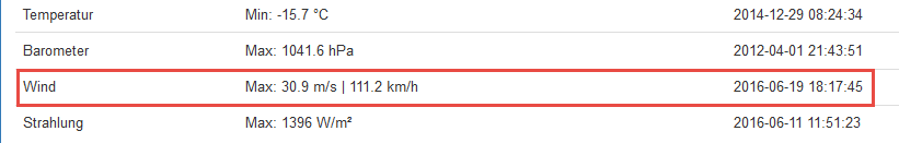

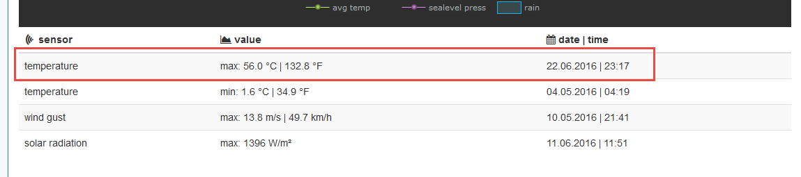

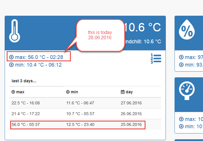

i have very high daily max temp values. The issue started on 19.06.2016.
[th0temp-dmax.1:--] 56°C and wind [wind0wind-dmax=kmh.1:0] 111.2 km/h.
the only thing i can see at the moment is, that this happens every 3rd Day.
Started on 19.06. then on 22.06. then 25.06. and today 28.06. everytime exactly 56°C Daily Max Temp. The max-value from the wind happend just on the 19.06.2016 :shock: :?: There is no scheduled reboot on the MBPro, i did that everytime manually, cause i was convinced that this maybe solves the problem.
The actual datas seems to be ok, during the day, just the daily max values are wrong. Can' describe it better! here are some printscreens!
(SW Version: Meteobridge 2.9 (Jun 18 2016, build 9941), FW 1.4)
wind just happend once (19.06.)
