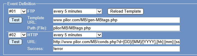

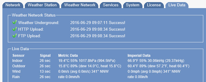

I have just started using my new Meteobridge, Live data is OK. Uploads to the website home page appear to be complete.
MBtags.php, MBrealtime.txt and MBrealtimegauges.txt are on server and current.
Note: there are two MBtags.php, one the original 2013 version and the 2nd is the current up-to-date version
But the website Status Page is showing 'not current' plus showing wrong version of MB and Trends page is incorrect except for the Current line
The Ajax-dashboard doesn't update http://www.pilor.com/MB/ajax-dashboard.php
Also not sure what to put in for Success in #02 if anything?
I am running my original website http://www.pilor.com and the new MB website http://www.pilor.com/mb/wxindex.php at the same time using port 22222 for the computer to connect to the Davis VP2
This is also posted on http://www.wxforum.net/index.php?topic=29766.0
Any suggestions would be appreciated.
Thanks...Don

Well I feel a little sheepish but relieved.
When I put MBtags.php into #01 I somehow added two blank spaces behind ".php" which changed the extension name to ".php " This was the reason I had 2 copies of the file on the website but they both looked the same as you can't see the 2 extra characters.
All is well in computerland again. :)
