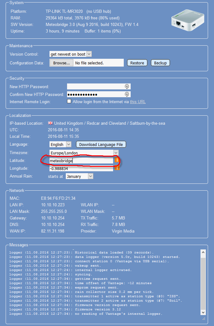

Post by stewart45 »
Meteobridge keeps changing my Latitude setting for no reason (see attachment) as a result it keeps asking for a language file to be installed, very strange
Re: Meteobridge changing Latitude setting
stewart45 wrote:Meteobridge keeps changing my Latitude setting for no reason (see attachment) as a result it keeps asking for a language file to be installed, very strange
1. That language file button is always selectable and colored light blue, that is normal.
2. I would change the settings for the Security part, leave both fields blank. as long as the "Internet Remote Login" filed is not checked.
Now the "Confirm New HTTP password" has data, the "New HTTP password" does not has data.
And the word meteobridge is the default password, so it seems to be displayed in the wrong field.

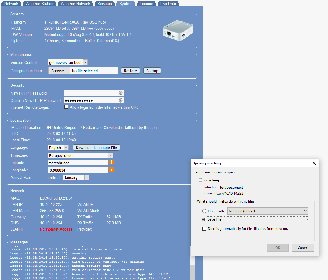

Post by stewart45 »
What i'm getting each time i log in locally is a splash screen about downloading a language file which i think is something to do with the word meteobridge being in the lat window (see attachment)
stewart45 wrote:What i'm getting each time i log in locally is a splash screen about downloading a language file which i think is something to do with the word meteobridge being in the lat window (see attachment)
That pop-up is shown when someone (or a browser-script) hits the "Download language File" button.
Did you try to use a different browser? Chrome for example?
I think FF is the one loading wrong data in the security entry-fields and hitting the button.
Those Security fields should be totally empty when you log on.
Normal situation is three empty fields without dots hiding the new password.
Maybe you set FF or a FF-add-on to automatically fill all passwords fields. There is an icon "lock with a circle" in those fields.

Those lock with circle are put there by Lastpass a password generator and security software I use, that maybe causing the problem will have a look into that, thanks
Just checked and Lastpass was the problem
