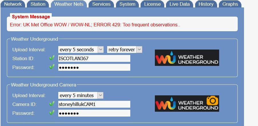

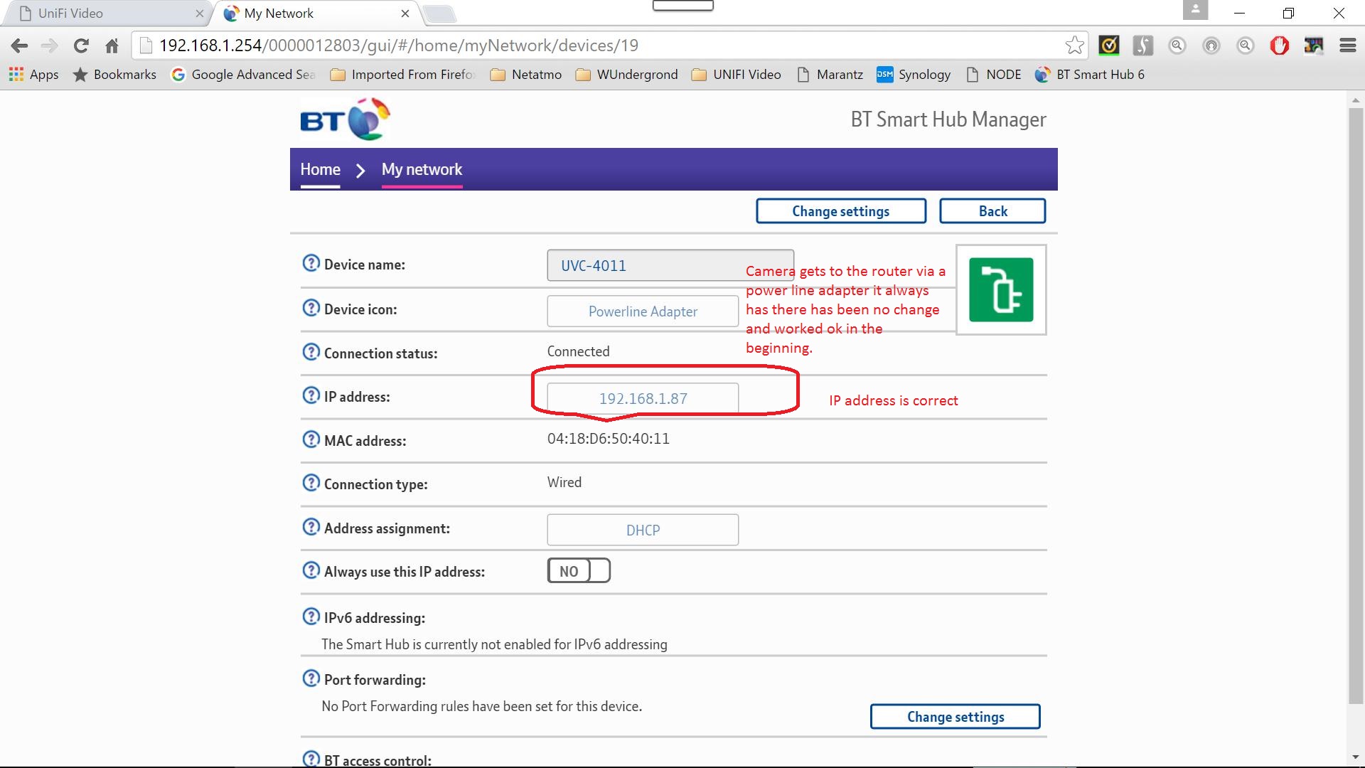

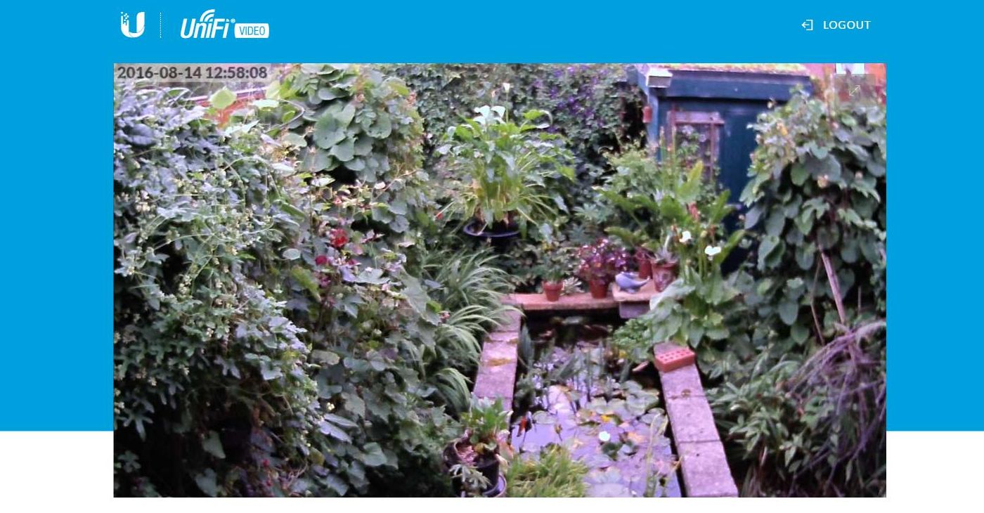

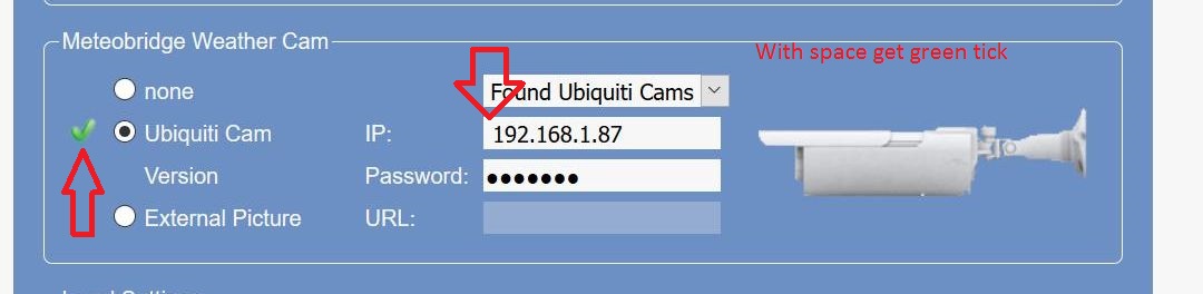

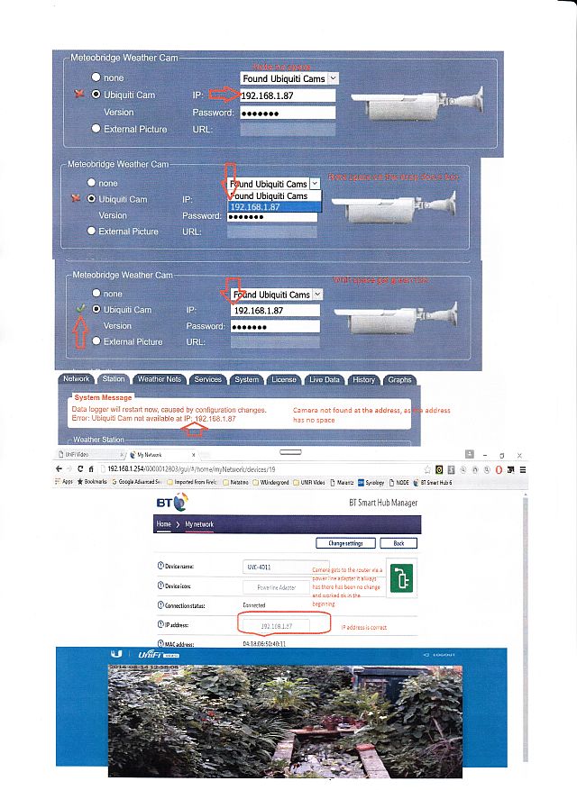

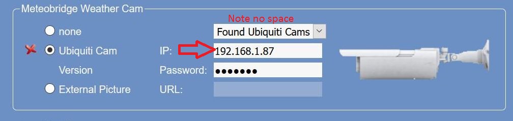

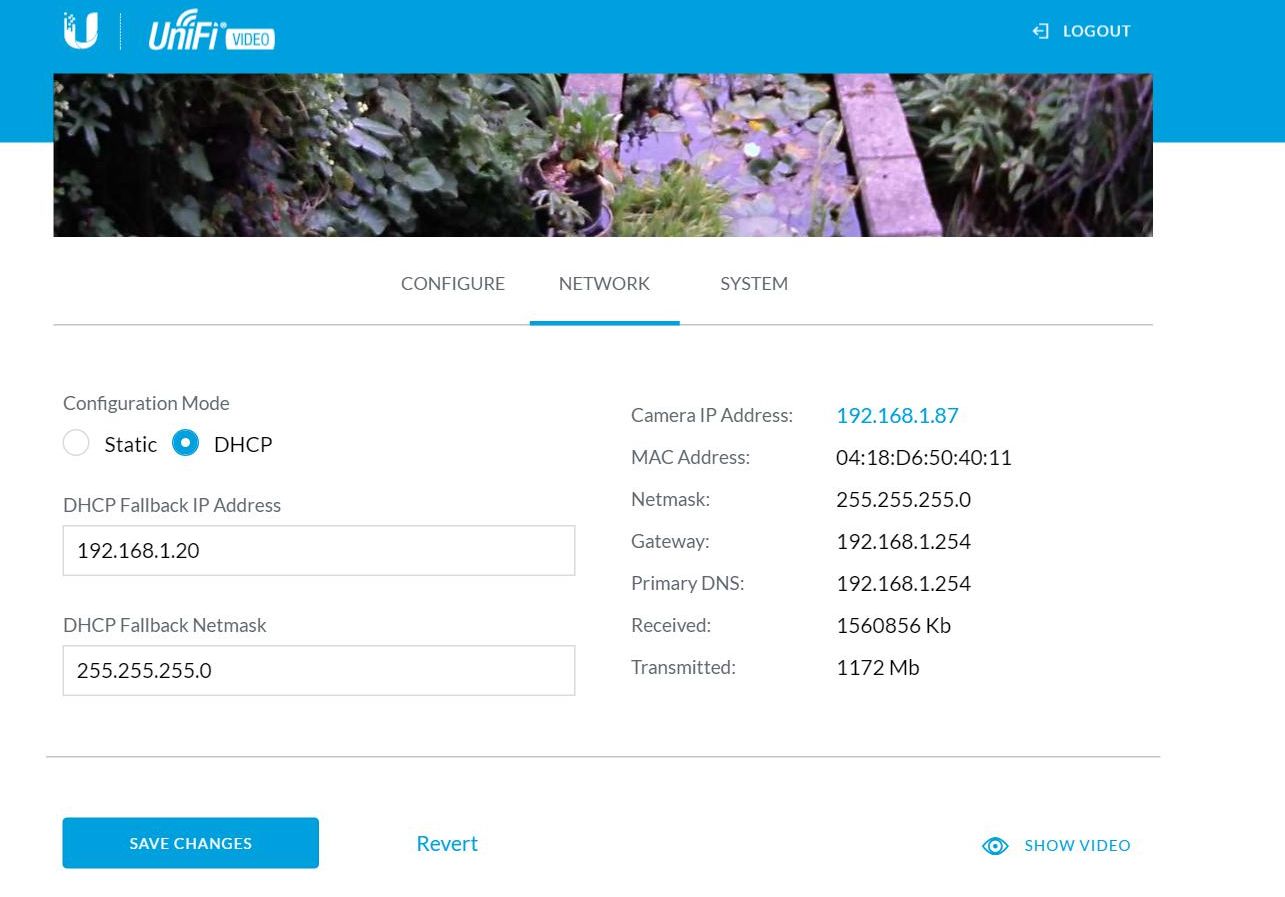

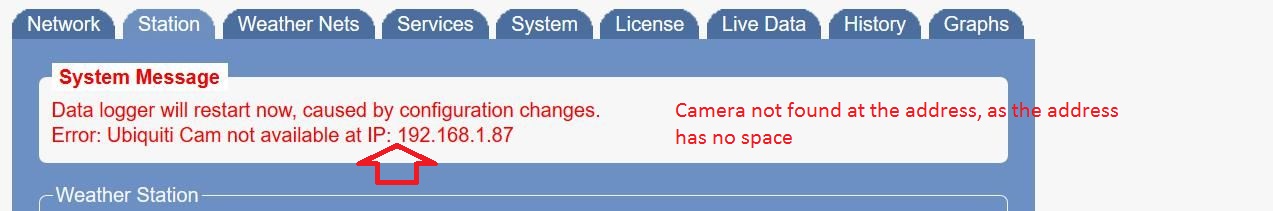

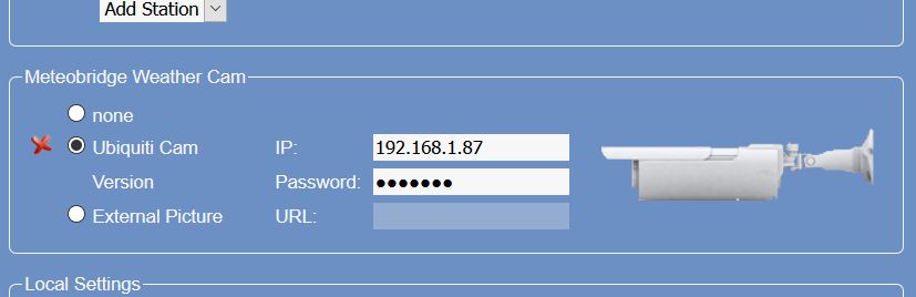

I wonder if you can help. My web cam stopped sending images to WU on the 7th May 2016 after a reboot The camera details are correct and green ticked on the weather nets tab for the added WU camera. I've tried a number of times to reset it but not had enough time till now to check out what was going on. Basically MBPro appears to be adding a space at the front of the IP address when it finds the camera. Without the space the camera gets a red cross, with the space it gets a green tick. but the camera is not really found as the massage says at the top of the page as it is at the address without the space. I've added some screen captures so this makes sense including one from the camera so it is working!

Bigger images so you can read the text. The Meteobridge Weather Camera is shoing a picture from 19th May 9.55 pm aand the last WU image is 8th May at 4.51am
