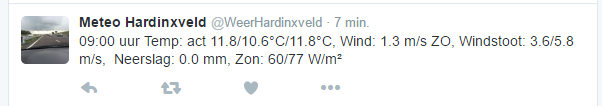

2016-10-04 09_07_54-(3) Twitter.png (13.61 KiB) Viewed 4930 times
