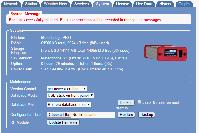

I have inserted USB-stick in the Front-USB.
Changed Database Media to USB stick on front panel and rebooted.
System Message
System Message

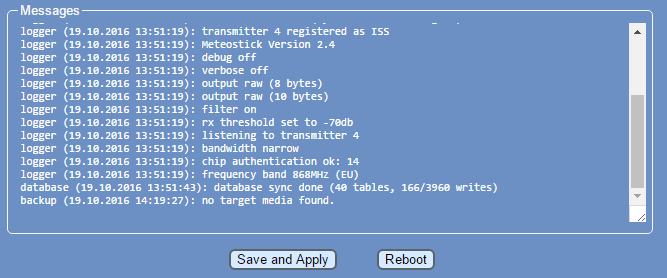

When I click the ‘backup’ button the messages log says ‘no target media found’

I am having the same problem it shows it recognizes the usb in the front position but wont right to it.
Under the system tab it shows the usb stick as 14432 MB total, 14386MB free(0%) used
I have rebooted numerous time both software reboot and a full power down reboot

Re: USB Backup: No target media found.
When you tell MB PRO to use the USB stick connected to the front panel instead of the internal one,
then you cannot also backup data to the same stick.
When you just want to do backups, then go with the internal stick as usual and just schedule
backups onto a USB stick inserted on front panel. Before doing so, you have to format the
external USB stick in FAT32. Once you tell MB PRO to use the stick as default storage
media it will be reformatted and will no longer work as a backup stick... until you
repartition and reformat is again to standard FAT32.
