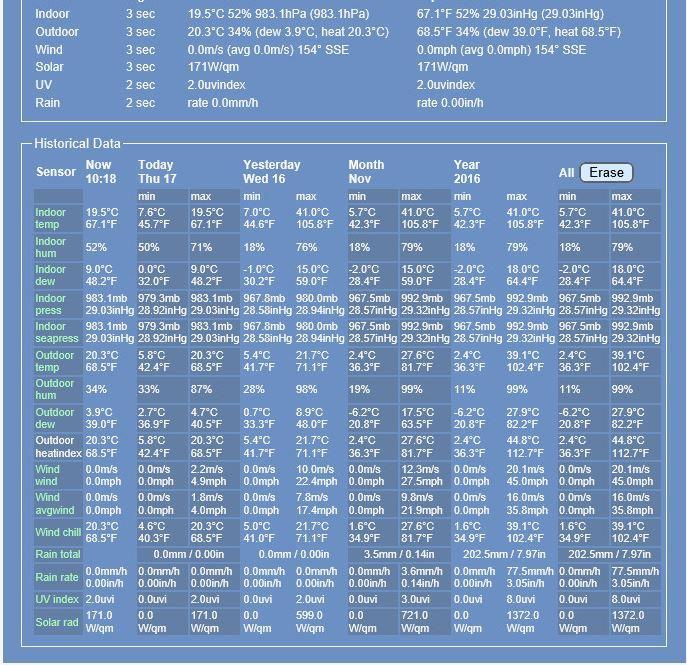

Thanks for your help. I don't seem to have the option to remove a sensor -- only block it. Then after blocking it, none of my options with other sensors change. Attaching screen shot.
Screen Shot
Screen Shot

Thanks again for your help. I did as instructed and the commands seemed to execute without error, however nothing seems to have changed on the live data screen:
First command output:
command: sed -i /prim_/d /root/meteobridge.conf
Second command output:
command: rcloggerd restart
Stopping loggerd... wait done.
Starting loggerd... done.
