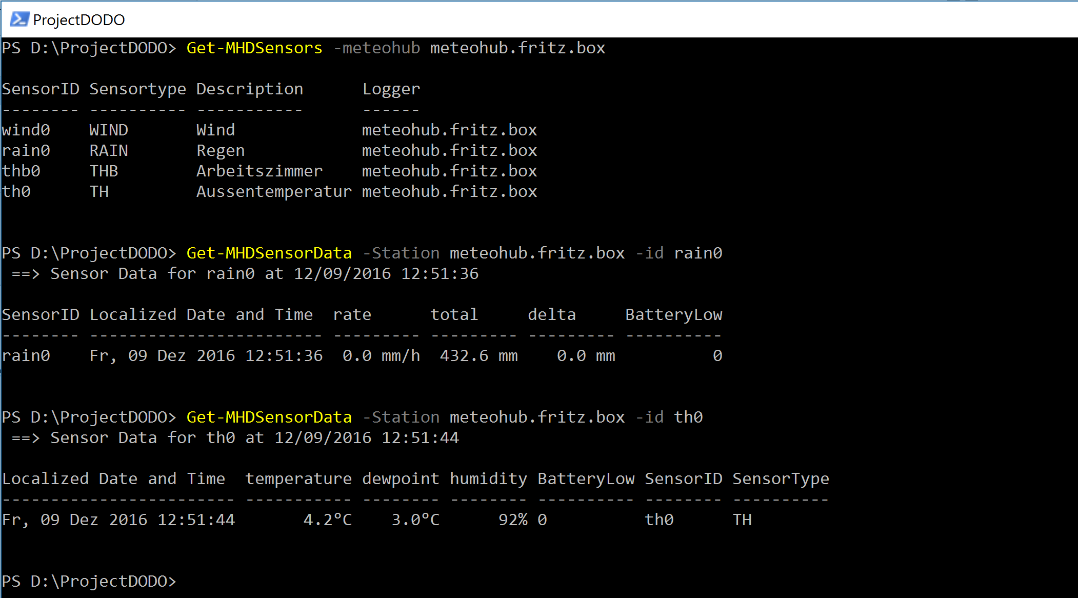

My solution is a ( docker based ) grafana/influx scenario, a n a powershell module that i have written to get data from meteohub
I am using the HTTP interface of meteohub to query sensors / sensordata.
The query transvers the data to a System Date Time Format

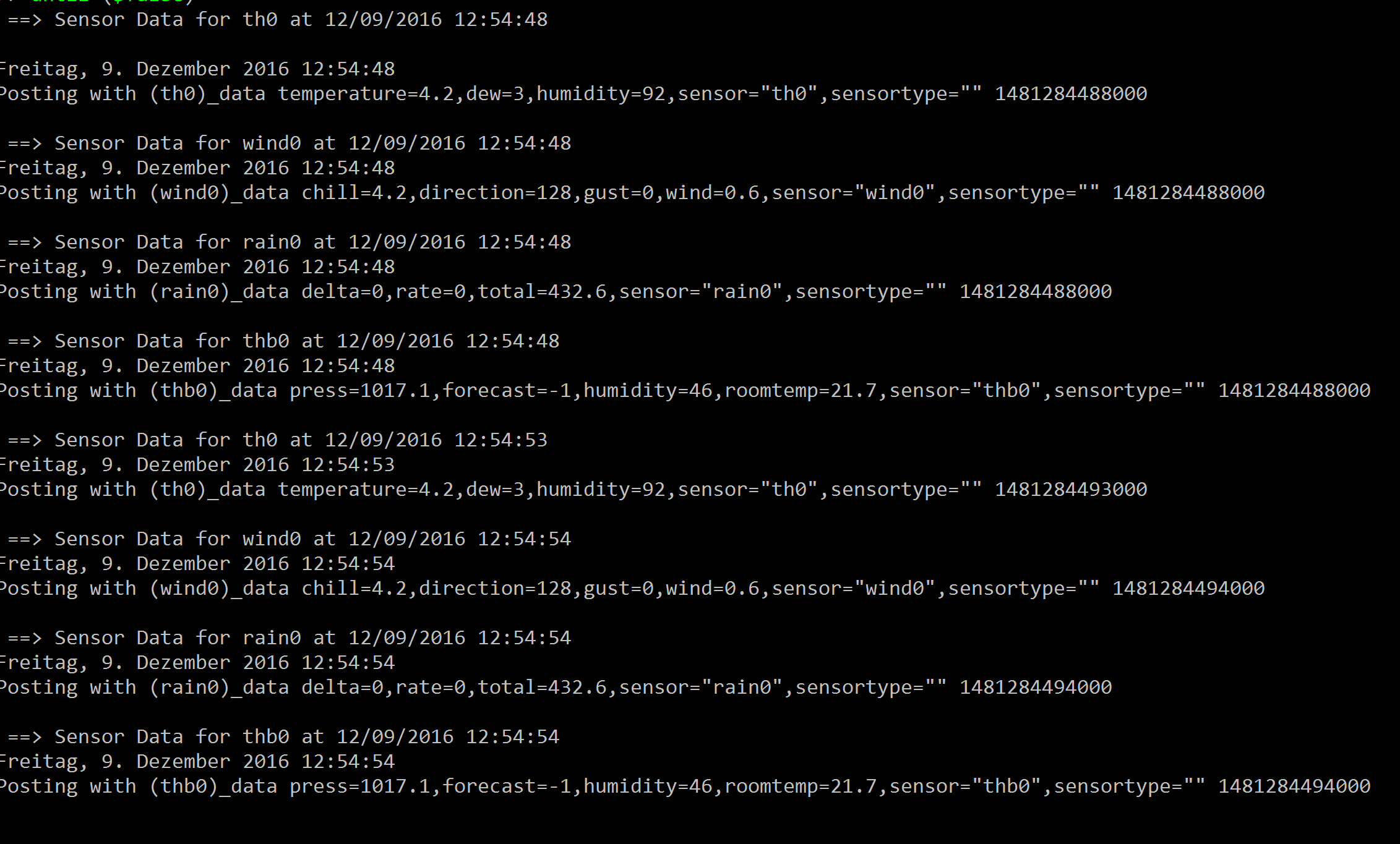

the data is tsent ao a influxdb as linserial dat with epoch time:

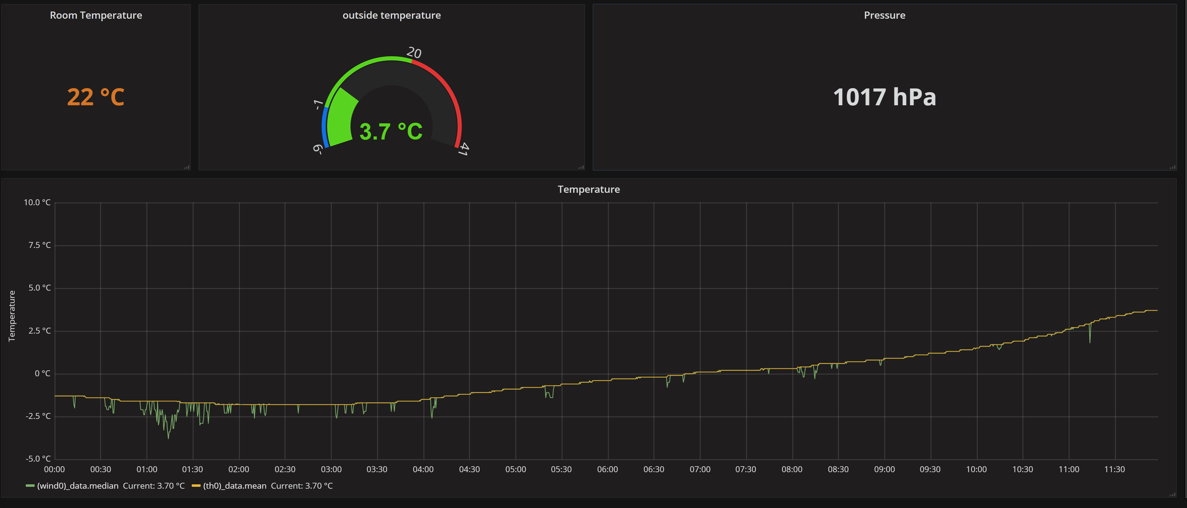

and then graphs are created in grafana:
