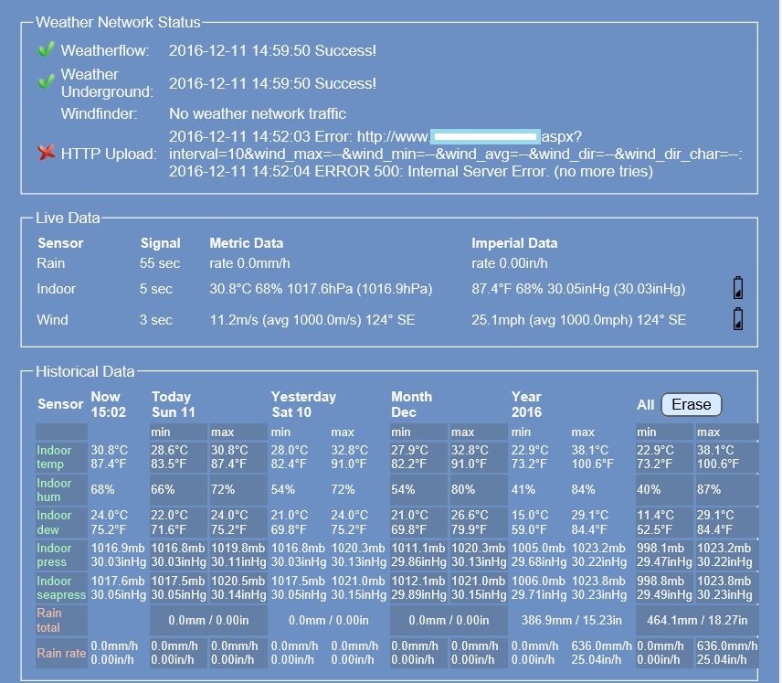

Recently my MB stopped updating my website with wind sensor readings.
The weather station, Davis Vantage Pro 2, receives the wind sensor information and MB gets it in Live data too but not in Historical.
The temperature/humidity sensor doesn't work but I don't really need it - all I care about is wind readings.
The logger displays this message every couple of seconds:
logger (11.12.2016 14:53:54): Bad wind0(0) sensor data, "chill x10" (18026) out of range [-700:1500]
logger (11.12.2016 14:53:56): Bad wind0(0) sensor data, "chill x10" (909128224) out of range [-700:1500]
logger (11.12.2016 14:53:58): Bad wind0(0) sensor data, "chill x10" (18026) out of range [-700:1500]
logger (11.12.2016 14:54:00): Bad wind0(0) sensor data, "chill x10" (909128224) out of range [-700:1500]
logger (11.12.2016 14:54:03): Bad wind0(0) sensor data, "chill x10" (18026) out of range [-700:1500]
logger (11.12.2016 14:54:04): Bad wind0(0) sensor data, "chill x10" (909128224) out of range [-700:1500]
logger (11.12.2016 14:54:08): Bad wind0(0) sensor data, "chill x10" (18026) out of range [-700:1500]

Could anybody help me with that issue, please?
Re: No wind sensor reading in historical data
That really looks like a bug. Which kind of station do you have connected?
Could you please give me remote access so that I can dig deeper?
Link: viewtopic.php?f=57&t=9885

The weather station is Davis Vantage Pro2.
I've sent the URL and login password as requested.
