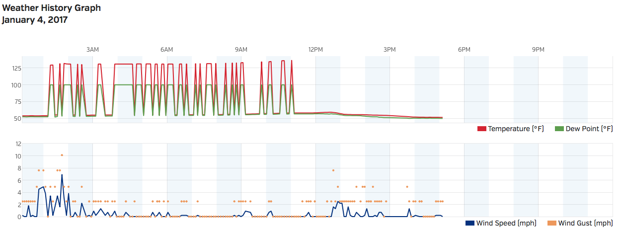

Here is a screenshot of my station KCASANJO392 on Weather Underground:
Crazy temps from Meteobridge on WUnderground
Any help greatly appreciated as this has "polluted" my data on Weather Underground!! :cry:

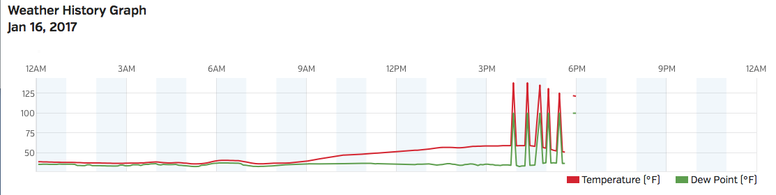

Unfortunately after a reboot (a couple times) this time it does not seem to fix the issue. Is my Meteobridge corrupted somehow and need to be reflashed?
Underground data
Underground data

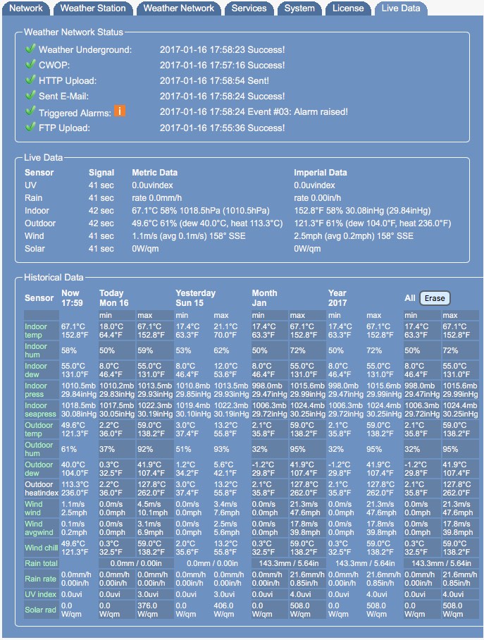

Here is the Meteobridge Live Data:
Live Data screenshot
