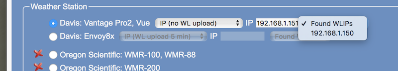

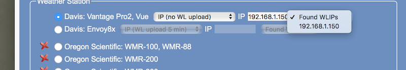

I have two WeatherLinkIPs on my local network ... one at .150 and another at .151. Meteobridge uses .150 just fine. In Meteobrige Weather Station "Found WLIPs" drop-down, only the first WeatherLinkIP is displayed. Even if I change Meteobridge to use the other WeatherLinkIP at .151, the drop-down selection box still only shows the first WeatherLinkIP at .150.
This is very minor as the address can be manually entered of the secondary WeatherLinkIP, but I believe is a bug in your design given the drop-down and use of "Found WLIPs" is displayed.
Screen Shot 2017-01-21 at 6.58.17 AM.png (91.75 KiB) Viewed 1832 times
Screen Shot 2017-01-21 at 6.54.29 AM.png (87.91 KiB) Viewed 1832 times

Meteobridge does a scan during boot, if it can find any WLIP related MACs in your LAN.
But it just records one, afaik.
