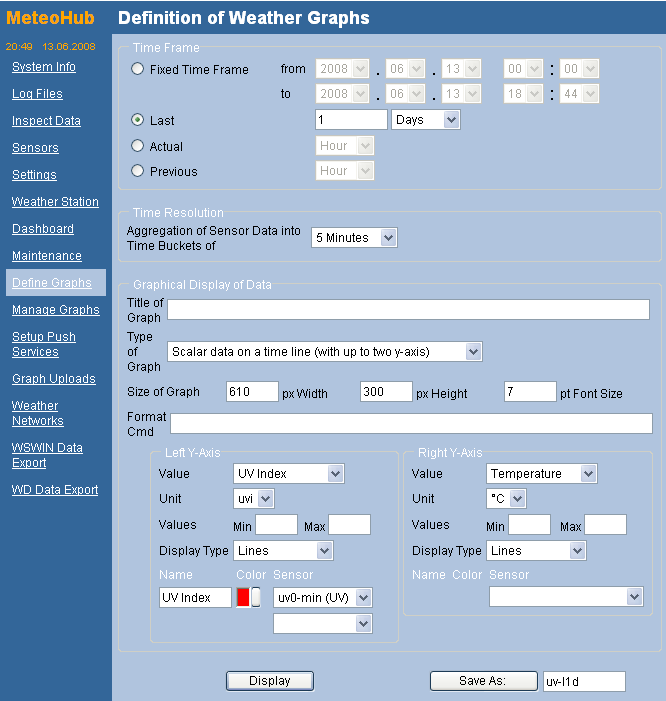

i get this error when i try to display my new oregon uv800 graphs:
plot /srv/www/cgi-bin/goto.cgi (null)0-min5 20080612000000' using 1:0 axis x1y1 title "UV Index" with lines linecolor rgb "#ff0000" ^ "/tmp/meteoQt0UhR", line 33: warning: Skipping data file with no valid points
plot /srv/www/cgi-bin/goto.cgi (null)0-min5 20080612000000' using 1:0 axis x1y1 title "UV Index" with lines linecolor rgb "#ff0000" ^ "/tmp/meteoQt0UhR", line 33: all points y value undefined! Content-type: image/png
using these settings:
there is enough data available:

i think something is wrong in the plot command (because of the null-value there: (null)0-min5).
or did i do something wrong?

your graph definition looks ok to me. The message \"all points y value undefined!\" indicates that there is no time-compacted data in the requested time resolution (here min5) and tine frame.
When you want to check, if there is time-compacted data, you have to inspect the file /public/weather/uv0-min5 not the raw data file printed above.
I guess, it will work, if you try it now, as the background processes will have computed the values in the meantime. If not, please start a recomputation manually (maintenance page).

only graphing the data of the last day (using the above settings) still fails with the same error:
plot '< /srv/www/cgi-bin/goto.cgi (null)0-min5 20080625000000' using 1:0 axis x1y1 title "UV Index" with lines linecolor rgb "#ff0000" ^ "/tmp/meteouS8ZAU", line 33: warning: Skipping data file with no valid points plot '< /srv/www/cgi-bin/goto.cgi (null)0-min5 20080625000000' using 1:0 axis x1y1 title "UV Index" with lines linecolor rgb "#ff0000" ^ "/tmp/meteouS8ZAU", line 33: all points y value undefined! Content-type: image/png
really have no idea what could be wrong. all other graphs work fine with the same settings :(

this is a bug that only occurs when using uv#-min or uv#-max in the graphs. It will be fixed with the next update 2.4c.
