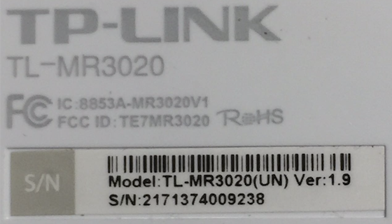

WARNING: TP-Link has given us an unpleasant surprise by bringing a modified version of the MR3020 onto the market. The unit looks exactly like the old one but is marked as "MR3020(UN)" on the back and is given a "Ver: 1.9" tag. When you flash this router model with Meteobridge firmware it is bricked. So please check the sticker at the back before flashing! We currently don't have an image that works with this new 1.9 version of the MR3020. On the picture below you see the sticker that indicates the router being a bad one, not suited for Meteobridge. Keep away from those models.
HINT: You have the same sticker on the bottom of the sealed box, so you can return those models without breaking the seals.

I am working on a new image that also handles these new models. Difference is a new NOR flash chip inside, which the openwrt kernel I use does not support. I try to patch that, but we will see...
Anyway, once the unit is bricked, you cannot give it a second try. So please don't flash "Ver 1.9" marked MR3020 right now. Some "Ver 1.9" still have the older chip, but you can't see from outside. Not very great what TP-Link is doing here and this looks like a week end full of work coming ahead ;-)
