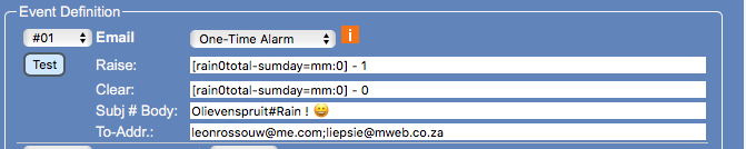

Maybe someone can help me ...
I am trying to set an alarm condition to email me when it starts to rain.
So I want it to raise the condition when more than 1mm of rain has fallen and clear the condition when 0 rainfall.
Please see attached screen shot .
The test email is working and I have just had first bit of rai for the season (South Africa) but it did not raise the alarm and I am obviously doing something wrong :roll:
Ay help will be greatly appreciated. :D
Regards,
Leon Rossouw.
Screen Shot 2017-10-01 at 13.21.59.png (25.28 KiB) Viewed 1863 times

This will not work as the alarm is immediately cleared when raised. When both conditions are true, no alarm is fired.
I would trigger on rain rate and clear when rain rate is zero again.
raise: [rain0rate-act.0:0] > 0
clear: [rain0rate-act.0:0] == 0
