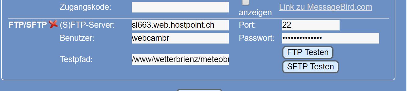

Re: SFTP Problem
I don't see any SFTP services defined. You have to replace the existing FTP requests by explicit SFTP ones. SFTP is a different service category.
webcam
Posts: 89
Re: SFTP Problem
Post by webcam »
Ok, but the test SFTP must function.
Or have I got that wrong?

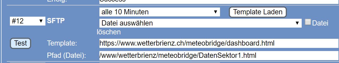

When I configure an event with SFTP, my system spins completely.

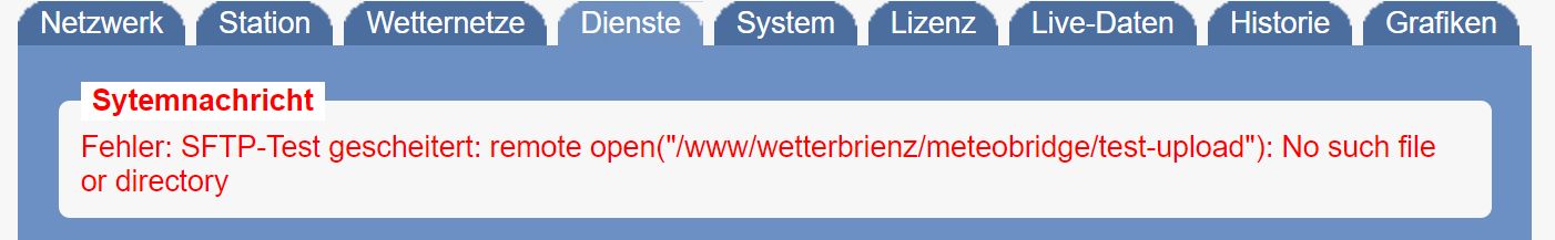

Re: SFTP Problem
As the error message tells you "/www/wetterbrienz/meteobridge/" is not a valid path regarding the home directory of your SSH user. Paths are not to be expected the same when using SSH or FTP. I prefixed your path by a "." to tell the system that it should start descending the path from the user directory and not from root and then it works.
